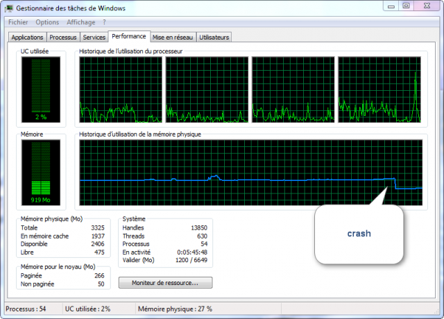

1000 files means most probably that the program reached its 2GB addressable memory space for a 32bit process. Hence "Out of Memory error". You can look for it in Task Manager/Resource Monitor looking for the Total Peak Memory usage for the process just before it dies. I know that Pierre is aware of the problem, but for this very concrete module I don't know now how to implement a "window" (iow, to discard some files already processed) in order to conserve memory.
Of course, using the x64 version will cure the problem. Yes, I know. Been there, done that. :)
Just be sure that it is an Out of (addressable) Memory issue for a 32bit process.
Note: Perhaps your tool will measure the process's private bytes hence will show "just" 1,7-1,8 GB of memory allocated.

I'm a little surprised by the memory problem as I did not have any problem with bigger directories in previous versions. But I'm not sure xcf files were involved. I will make some more tests to see. Well, a good reason to install Windows64 bits but I'm too lazy for this.

Some tests: for a 3000 files only jpg directory, no crash. For a 15 files mixed files with some xcf no crash, with 1000 files mixed crash. I put the screen capture of memory and CPU usage.
