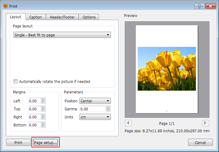

It's here:

For me, A4 is set when I open XnViewMP, and my printer has A4 paper in it...

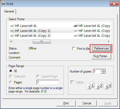

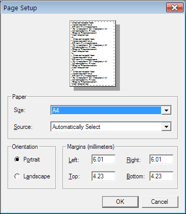

Possibly something you can set in your printer interface?? The print interface in XnViewMP is rather unusual (due to a limitation in the design of the QT5 framework, I believe) in that some settings only appear when you click on 'Print', which would normally be the last action which starts the printer:
You might look at the menu that appears when you click 'Print' and see if there is a setting that enables you to set the paper size, as in the 'Preferences' above in my printer interface which leads to a paper size setting.
