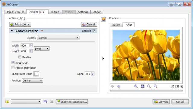

You should be able to do that using the 'Image > Canvas resize' action: you may need to experiment to find the most suitable 'Keep ratio' and 'Follow orientation' settings.taksina wrote:Can anybody guide me on how to crop a bunch of images from the centre and then resize to a specific size?

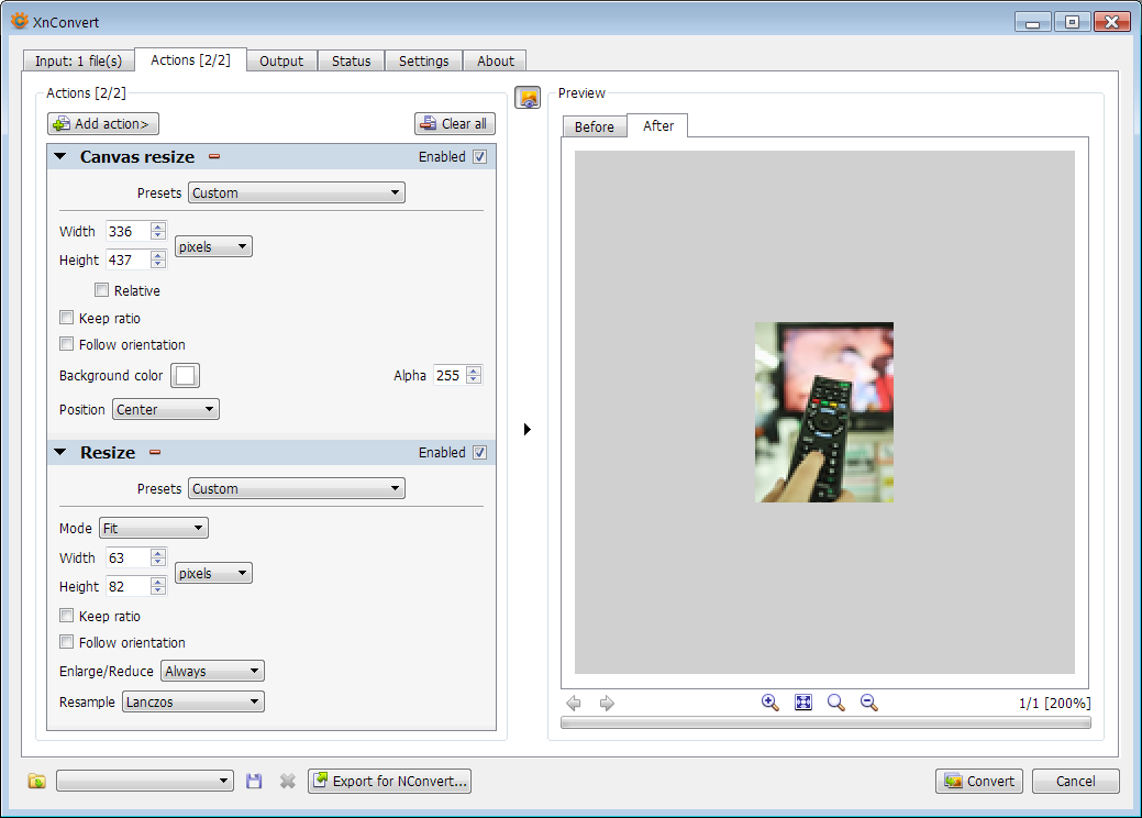

I'm slightly confused but could you try the following settings and let me know if they produce the result you want for landscape images like the one you posted:
The first action crops the input image about the center to the pixel height of the 'Before' image and a width calculated from the pixel width of the 'Before' image and the 63/82 width/height ratio of the thumbnail you want.
The second action rescales the cropped image to the thumbnail dimensions you want -- you might try different resampling methods to see if there is any difference in quality.
My output JPG file has a noticably smaller file size than yours but I don't see any very obvious difference in quality -- you can experiment with the JPG save settings on the Output tab. My output image is also very slightly displaced from yours, probably because it is cropped from the exact input image center, whereas you probably cropped by eye.
