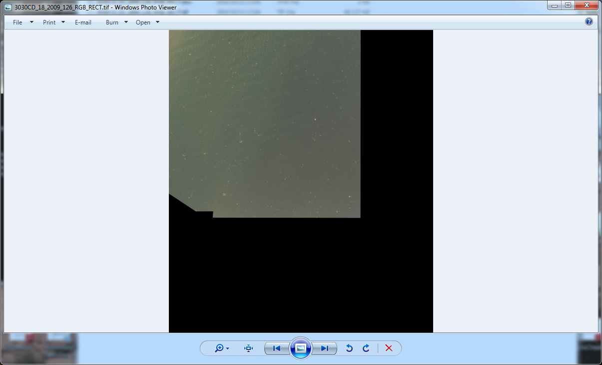

I have a bunch of images that get a "Convert to 8 bit" popup, and then the image is not displayed correctly.
Windows 7.1 Photo Viewer does open them correctly.
Xnview version is 2.24, libformat 6.60
The smallest image sample I can give you is 18MB - let me know if you want it.
Kind regards,
Zoltan

TIF image with Jpeg YCbCr opens incorrectly

Re: TIF image with Jpeg YCbCr opens incorrectly
I've put 2 files up, but only 1 of them is showing.
The first was just a screenshot so you can see what to expect (just a patch of sea off the East coast of South Africa - the other images are 40-80MB)
I then uploaded the TIFF - It took about 20 minutes, and did say "100%".
Email me off-list if I need to dropbox it, or use some other method.
Thanks & regards,
Zoltan

- Posts: 48933
please send me by PM a link to download the tiff
zoltan
