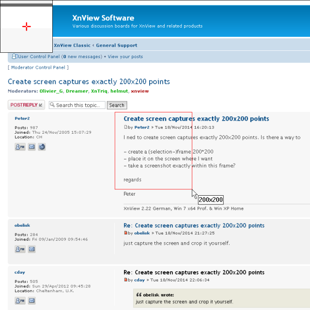

I ned to create screen captures exactly 200x200 points. Is there a way to
- create a (selection-)frame 200*200
- place it on the screen where I want
- take a screenshot exactly within this frame?

Is that what you're looking for, Peter?
- Tools » Capture screen... » Capture area » Rectangle

Yes, in theory. But it takes rather long time and a steady mouse-hand to create exactly 200x200. It would be fine if the size of the rectangle could be predefined - and then used ("Snagit" has this feature.)XnTriq wrote:...
Peter

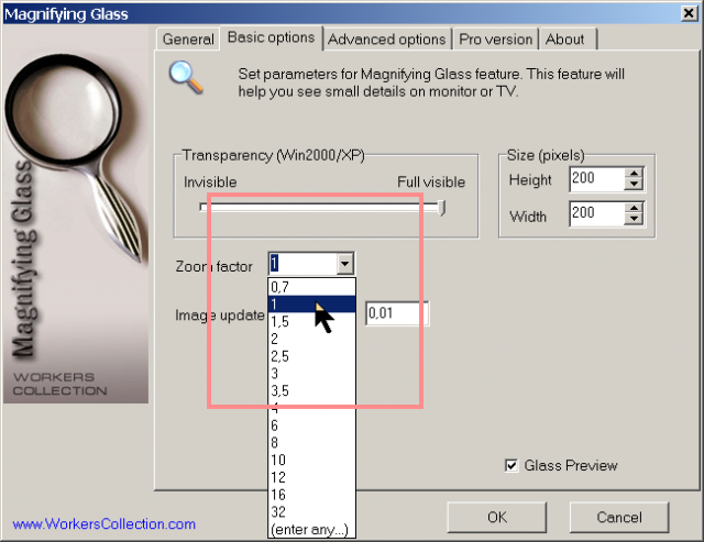

You could use a screen magnifier and set the zoom factor to 100%.
- Microsoft: Magnifier
- Iconico: Magnifier (capture function but no 1× zoom)
- Workers Collection: Magnifying Glass
- Screen Magnifiers: Windows Freeware and shareware
- List Of Freeware: List Of Best Free Screen Magnifiers
