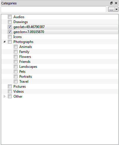

when opening this file, the "geo" keywords are used as categories as shown in the screen shot below:
without hierarchical categories

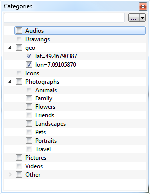

But what I would expect after enabling the option Settings->Metadata->read hierarchical keywords->[x]: is a hierarchical category structure like this:
with hierarchical categories

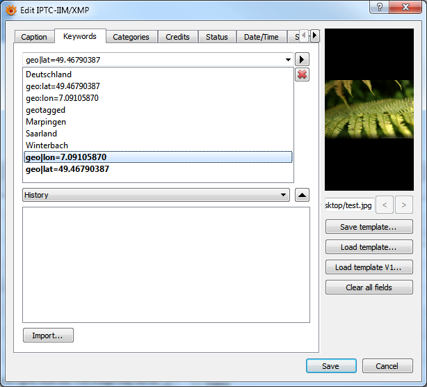

If edit the IPTC meta data and add some "geo" keywords that contain | as separator, the hierarchical categories are created as shown in the 2nd screen shot above. But I think this should also work with :, if I interpret the "read hierarchical keywords" option correctly.
