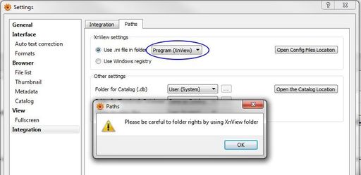

This is a security enforcement since Windows Vista where a normal user cannot affect the \Program folder and is similar to the restrictions in the Unix world.
The solution is to store the .ini file in a folder made for purpose: C:\ProgramData (system variable %ProgramData=%) - equivalent to /etc in Unix world

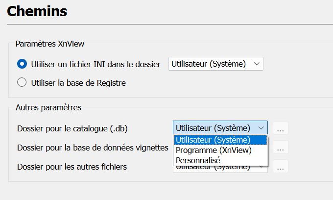

Back to this proposal, I see there is a "Custom" option available for the catalog and for other files. Why not adding this option for the .ini files as well ?
This would allow anyone to select \ProgramData\XnViewMP (example for Windows) which is the right location to store the .ini file in case one would ensure the settings are consistent for all users of the machine.
Reminder the current option "Program (XnView)" doesn't work (Windows, Mac, Linux) as the program folder is always protected against tampering the system. To me this option is useless - only use could be for "Portable version" on USB key.
The best would be to replace the Program option by a customisable option (set by default to \ProgramData\XnViewMP vor Windows and equivalent for Mac and Linux)

B.Douille wrote: Sun Feb 18, 2024 9:25 pm Back to this proposal, I see there is a "Custom" option available for the catalog and for other files. Why not adding this option for the .ini files as well ?
that may be handy

Bellow is a screenshot of the current behavior of the option "Program (XnView)" when it was installed via normal setup. The warning doesn't mean anything for an average user, may lead to unsecured change on the system and do not deliver the expected feature of sharing a consistent layout, shortcuts, toolbars, labels,... across all users of the machine. My proposal solves this.
