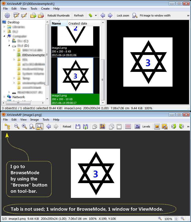

Pierre, I am sorry. The "Scenario 2a" should be as the following:
(I underlined the part I did not include)
Scenario 2a: (Problem: "Save Changed File" confirmation does not appear)
In View-Mode, I edit an image (e.g. crop).
I go to Browse-Mode.
("Save Changed File" confirmation does not appear)
I double-click another image and View-Mode opens displaying that second image.
I edit the second image.
After editing the second image, I go to Browse-Mode.
I double-click the third image.
I go to the next/previous images.
Please try the following:
- Put 3 images (named: image1, image2, image3) in a folder.
- In ViewMode, crop image1. Do not save it. Go to BrowseMode. (save confirmation does not appear)
- In BrowseMode, double-click image2. Crop it. Do not save it. Go to BrowseMode. (save confirmation does not appear)
- In BrowseMode, double-click image3. Now, in ViewMode, I can go to previous/next images and save confirmation does not appear. Also, the images displayed by ViewMode are the original images; not the edited ones. (**)
- Go to BrowseMode. Double-click image1. Now, ViewMode does display the edited image1. If I got to next/previous image, the save confirmation does appear.
(**) In BrowseMode, the thumbnails and previews are also of the original images; not the edited ones.
Did you see the same behaviour of xnviewmp?
I have tried the features Crop, Rotate, Resize and xnviewmp shows the issue above.
You can imagine how confused I am if there are hundreds of images in a folder. :)
Is it possible to always have the save confirmation after I edit an image in ViewMode (but forget to save) and I go to BrowseMode?
Thanks.

The ViewMode of Xnviewmp on my laptop is not full-screen; has no tab; always has the tool bar.
To switch from ViewMode to BrowseMode, I click the "Browse" button on the tool bar.
The BrowseMode has the folder pane, thumbnail pane, and preview pane (from left to right).
To switch from BrowseMode to ViewMode, I double click the thumbnail of an image.
Since you mentioned the "tab" browser, now I can see that some users may edit an image in a ViewMode tab, but do not want to save it immediately and they, instead, use the browse tab and/or another view tab.
If the tabs are used, I can see that actually what I did was switching between tabs. I can understand why xnviewmp does not pop-up the save confirmation.
However, for users who do not use tab, xnviewmp behaviour can be confusing. I kept on asking myself "Why xnviewmp does not warn me when I leave an edited image without saving?"
Pierre, is it technically possible to have an option so that if there is an edited image in ViewMode (no tab and/or multiple tabs) and we switch to another tab (view tab and/or browse tab) then the save confirmation will appear?
In other words, perhaps, switching to any other tabs without saving an edited image in current tab will trigger the save confirmation.
Again, it should be an *option* and not by default.
Thanks.

and why you don't quit the view tab? you'll have the ask confirmation in this case

Posts: 48913
Re: "Save Changed File" confirmation before going to Browse-
ok, i understand, but the view is always opened, so if you don't close it, you'll have the confirmation dialog
