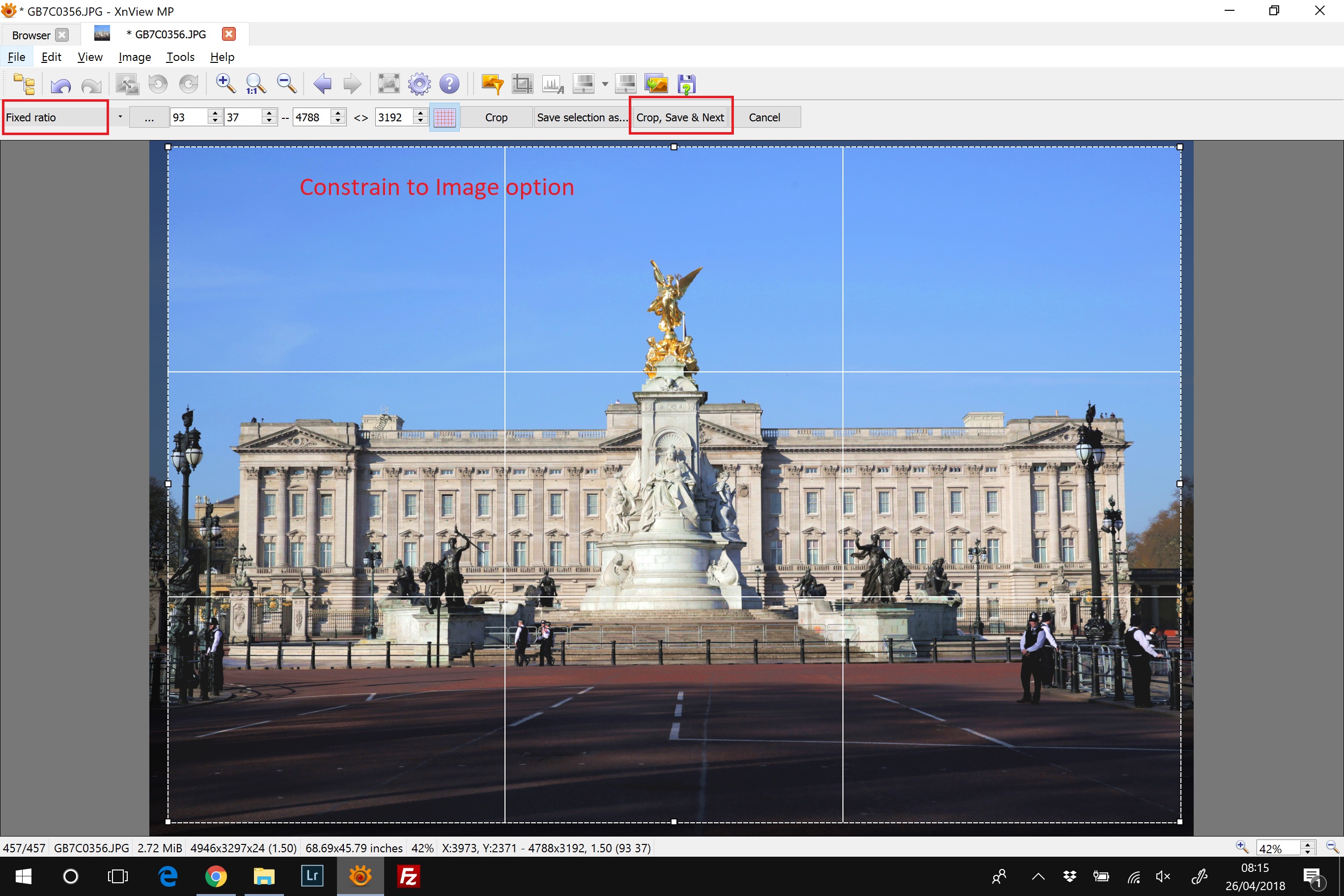

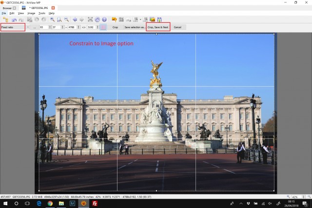

I think I have a similar request;
When shooting press work, I need to have a super fast workflow. XnView has been fantastic at speeding up captioning and renaming etc, thank you, I would very much like to speed up part of the editing process, but can't work out how!
1) I've created a crop size to match the original frame size, so I can quickly rotate any images that aren't quite straight, but I can't see a way to make my crop size the default, or set 'last used' as default.
I am working from the icons in the tool bar, again for speed.
2) I can't see a constrain crop to image option, to prevent my crop going outside the image borders. Again, speed working, it is not always easy to accurately keep the crop tool within those margins.
3) Is there a way to set the 'Crop, Save & Next' to 'Crop, Save AS & Next' so I can quickly save the adjusted images to a new (default) folder so as not to compromise the originals.
Thank you
Amanda

I'd also like to have the crop mode (via icon) start with a more useful value. Most of the time I don't want "free" crop. So it should either remember the last used value or be configurable in the settings. The "edit > set selection ratio" is no help here since I have to set it again for each image.
And I really like the suggestion 2) made by Amanda for a "constrain to image". Often when fine rotating an image I don't want to crop the maximum but a smaller area. It should be without black edges of course. I don't want to use the "automatic crop resulting image" feature since it crops to much. Think of an image where the most interesting part is in the top left corner. I want to fine rotate the image and keep as much of the corner as possible. That's why I skip the autocrop and do it manually. But now I have to view the image at 100% or more to fine tune that the selected area does not include pixels of the "area without information" created by the rotation. It would be a great help to have a checkbox which would ensure that the selection does not include pixels outside of the original image pixels. This way I could easily select while viewing the whole image.
3) would be helpful, too.
