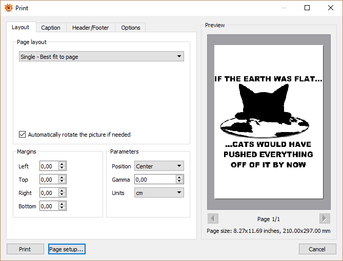

I mostly use custom paper sizes with "Microsoft Print to PDF" that comes with Windows 10 (here: Pro, v1803, x64). But I just tested it with a Ricoh MP C2003 with the same result (that is, it doesn't work with the latest two versions of xnView MP. With 0.90 it's working).
That's DIN A4, but it will show the same (=last chosen standard size) for custom sizes:
