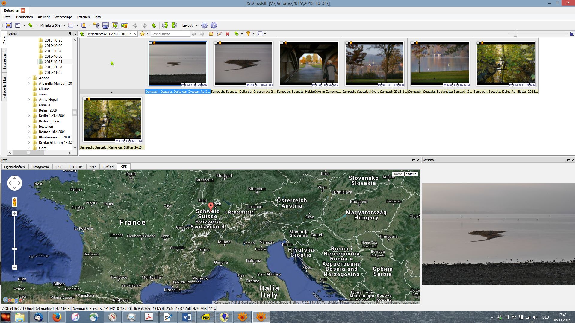

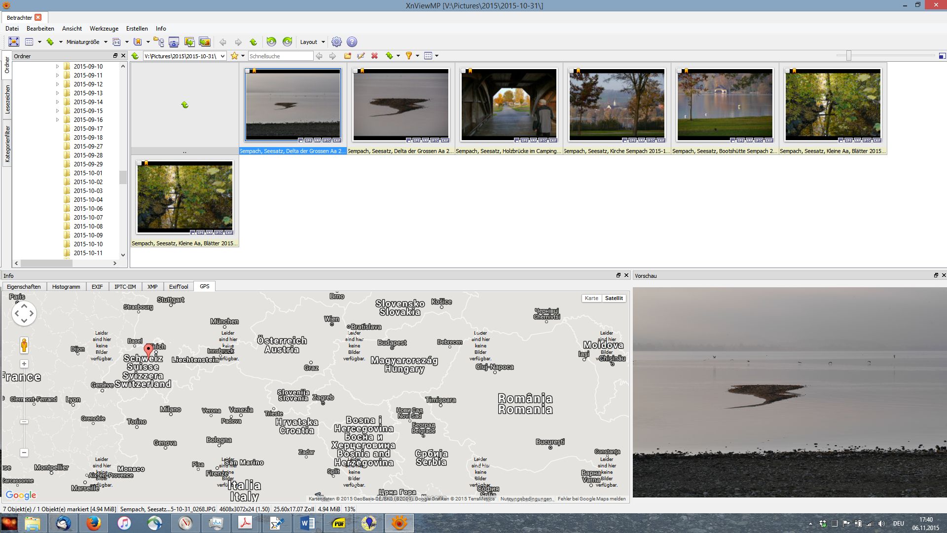

The first screenshot shows Version 0.72 with the map set to satellite. This is the installed version on this computer. The second screenshot shows Version 0.76.1 with map set to satellite. This version is run without installation. I have installed and uninstalled every version from 0.72 to 0.76.1. (with reboot etc). Only version 0.72 works with the satellite map.
The standard map works with all versions.
One observation: 0.72 uses QT4 all the others Qt5. Is there a problem with other software using Qt4 (or 5) in parallel?

You are right it works, but only if one copies the files from the zip-folder. I used the installer on the 64-bit version, and something was messed up.
