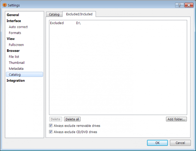

wurzelpete wrote:Is there a way to prevent XnViewMP from quering all available drives on loading up? My setup spins down most drives during regular day use and whenever I want to quickly open a picture from an active drive I have to wait for the unused drives to spin up before XnViewMP loads the picture from the active drive. Is this somehow preventable
This might be the answer:
Tools > Settings...
If not, it's probably a question for Pierre... :?:

Thanks for the tip but I already have pretty much every drive on that catalog list (was the only thing I found even remotely related to this in the menu options).
