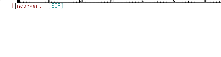

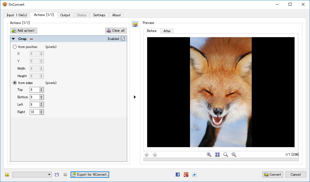

You can attach a file that is output in NConvert button when you set the trimming.
What kind of transformation from being output even if the set is only 10 characters of "nconvert ".
There's nothing happy be output such.
I what you have set in the GUI is output to the batch fill, the contents can not be set in the GUI (such as PNG of transparent color) had been expected to be able to add your own.
- Posts: 48626
Re: NConvert button not Work
"crop from position" is currently only supported by NConvert
