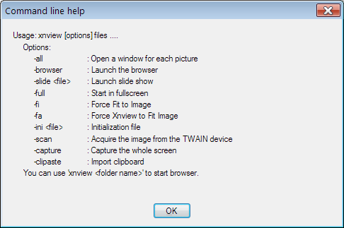

uberfly wrote:Maybe the current work around is saving custom ini files and swapping them out based on need - I will have to try this.
You might look at Info > Command line help... which has a switch to start XnView with a specified .ini file:
You could probably use the -ini <file> option to create alternative shortcuts that start the program with different ini settings... :D
