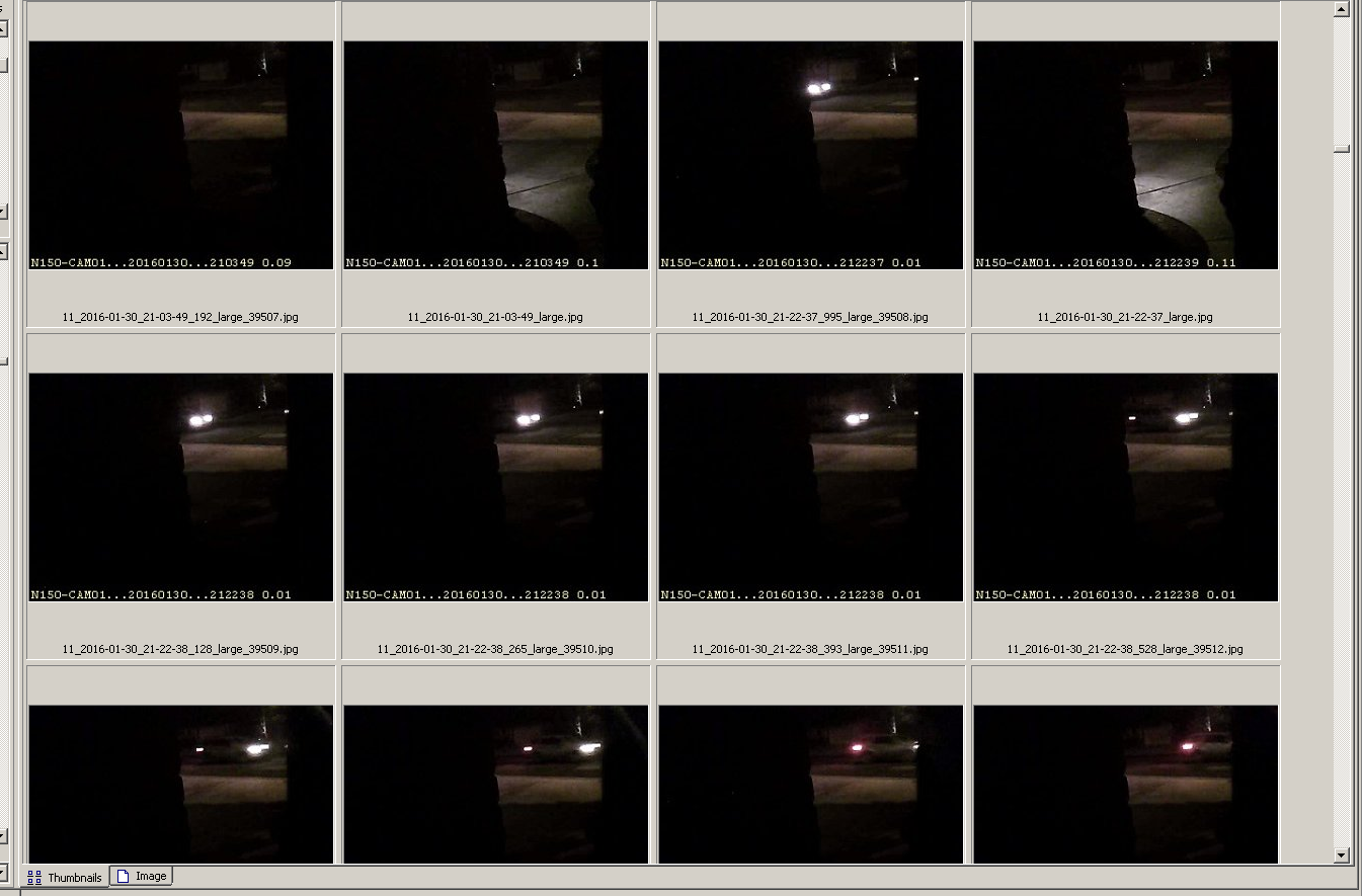

I've almost got XnViewMP behaving like XnView did, but still struggling with a couple of things?
1. I'm not able to select Filter by -> Images. I can select "all" or "custom". So, I deselected everything except images in the filter in settings. Now only folders and images are being displayed. In XnView, only images display, no folders. This causes no issue for me, just wondering how to fix it.
2. I have a lot of horizontal border around images displayed after a search. I set all border widths I could find to 0, and removed the display of tag, star, circle. But still there is a lot of space on either side of the images. (Vertical spacing is fine once I changed the display to just the filename.) How do I shrink the border on either side of the image to minimal spacing?

xnview wrote:Yes folder are displayed now with Images. But you can use a custom filter (settings>filelist>Custom filter)
Yes I have custom filter set to just images, nothing else, and still see the folders too. Again, not an issue, just curious if I can make it like XnView (no folder display).
xnview wrote:could you post a screenshot?
Posts: 47708
Re: XnView has stopped working - loading 25,000 jpgs
in XnView Classic, you are able to reduce this space?
perhaps by growing the height of your thumbnails?

My goal is somewhat different than that...
As I am using XnView to quickly scan my security camera images, my goal is always to find a large enough size for viewing, that I can fit in static positions on the screen page size. Then I can arrow down through the images quickly to 'scan' them for scene changes.
When I have XnView set this way, the physical placement of the images on the screen page doesn't change as the images do while moving through, and scene changes are fairly easy to notice.

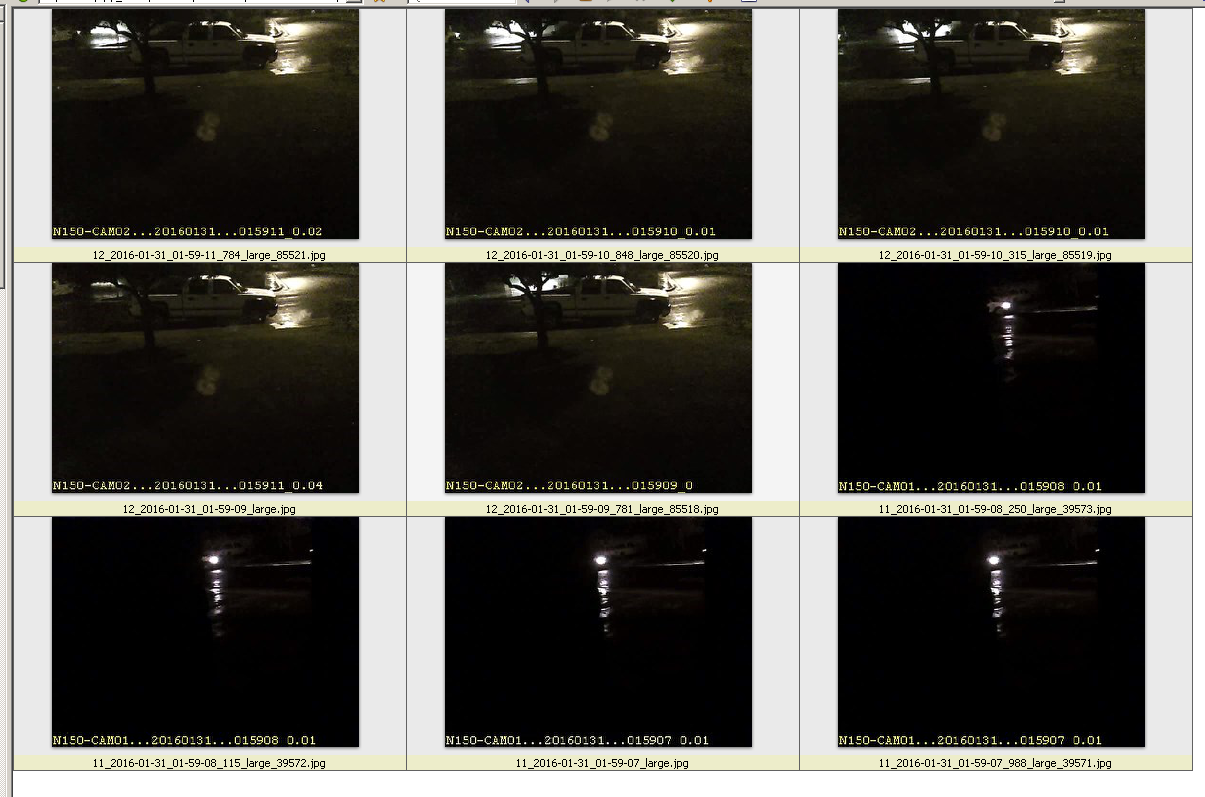

I have the same custom size thumbnails in both XnView and XnView64 right now, and both have three across and nine down with the horizontal spacing very similar to the XnVieMP screenshot above.
This is Vallen Jpegger, the thin horizontal spacing border shown is what I'm after in XnView/XnViewMP:
The thumbnails are nearly the same size as I have in XnView/XnViewMP, but I can fit four across in JPegger due to the thin border in between the images. Unfortunately JPegger is harder to use than XnView as I have less control on the vertical spacing and static image placement options on the displayed page.
Ultimately if pictures are close together with a thin border I gain a bit more flexibility for larger or more images on a static grid position.

By changing thumbnail size, i'm able to have something similar as Jpegger screenshot.
appyface
Posts: 49
Joined: Thu Sep 15, 2011 12:23 am
Post by appyface »
That hasn't been the answer for me so far but I'll play with it a bit more. Thank you.
