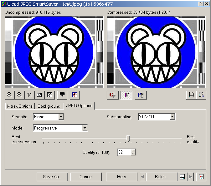

My request is for additional info on…
  • Estimated Compression Level (“Q Factor”)
    • 0 - 100
  • Chroma Subsampling
    • 4:4:4
    • 4:4:0
    • 4:2:2
    • 4:2:0
    • 4:1:1
    • 4:1:0
  • Mode
    • Baseline Standard
    • Baseline Optimized
    • Progressive
  • MCU Block Size
    • 8×8
    • 8×16
    • 16×8
    • 16×16
  • Smoothing Factor
    • 0 - 10
