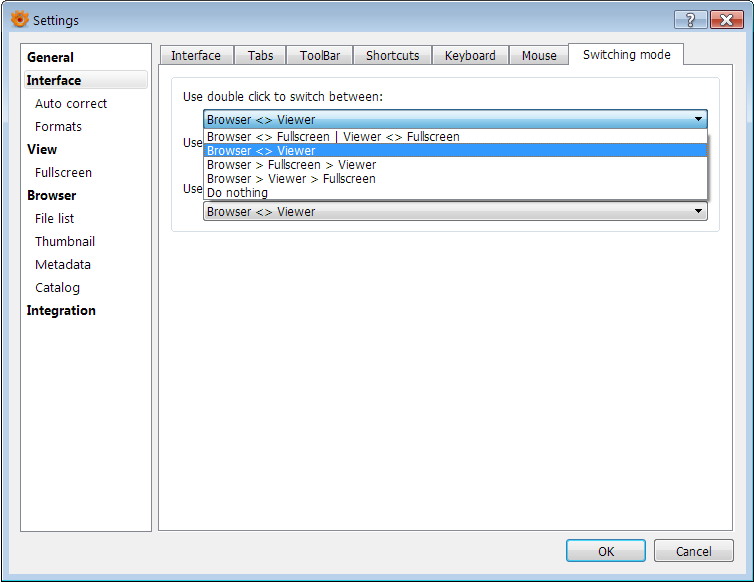

1) I cannot move files between folders by dragging them. The only thing that ever happens is copy, which is annoying. Is there any way to do this?
2) Is there any way to make the program NOT open images in fullscreen mode after doubleclicking on them? As in, the original XnView behavior. I have whole bunch of EXIF data added into the program's title bar just like in the original XN and it's no use now. I'd like images to open in "full view" mode like if you did so from the Xn's browser.

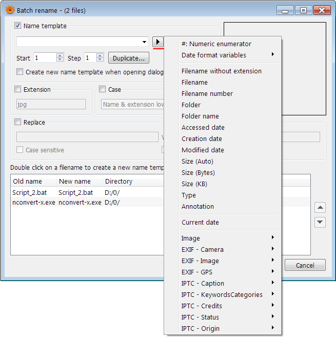

3) I used to be able to use some variables for batch renaming of files in the original XnView, but none of those work in MP. For example, I'd rename my photos like this: "2016-02-22-15-36-58.CR2".

Could you check this Tools > Settings... option and see if it provide the behaviour you need:Octopuss wrote:2) Is there any way to make the program NOT open images in fullscreen mode after doubleclicking on them? As in, the original XnView behavior. I have whole bunch of EXIF data added into the program's title bar just like in the original XN and it's no use now. I'd like images to open in "full view" mode like if you did so from the Xn's browser.
Does this Tools > Settings... option provide the format you need:Octopuss wrote:3) I used to be able to use some variables for batch renaming of files in the original XnView, but none of those work in MP. For example, I'd rename my photos like this: "2016-02-22-15-36-58.CR2".

For 2), I don't think it's relevant to my problem. What I'm talking about is the mode XnView opens in when I open an image directly from Windows explorer by double clicking on it. I don't want the image to open in fullscreen mode, but I couldn't figure out whether it's even possible.
For 3), yes, I eventually found that screen (but really some basic help or button tooltips are really needed), but when I choose anything from the "date format variables" menu, it just puts that variable letter in the preview name. I think it might actually be a bug.

2) General/General/Startup ( Untick Fullscreen when starting)

2) That works! Yay!Erixx haxx wrote:Hello:

3) It's not related to EXIF, it's the generic file attributes. The others work, it's just everything in the "date format variables" menu that's seemingly broken.

3) Ok, I just tried almost all of these and none seem to work in this section. The only date I could get to work are 'Modified" and "Created" Dates Vars.
Must be a BUG.Hopfully gets fixed, I Reported it Here: http://newsgroup.xnview.com/viewtopic.php?f=62&t=32898

which date variable? it works for meOctopuss wrote: 3) It's not related to EXIF, it's the generic file attributes. The others work, it's just everything in the "date format variables" menu that's seemingly broken.

3) DependsOctopuss wrote: 3) It's not related to EXIF
I also just found out you need an argument in front of, and inside brackets for these for it to work...
Example: {Creation Date [Y]}-##
This will rename by Exif year with a counter 2010-01, 2010-02

Ok I'll try to explain a little better.Octopuss wrote:That's too complicated for me to understand.
1) When you use Var "[Y]' for year, This means nothing to xnviewmp until you pick another Var telling xnview the year you want. Their is different years.
Exif year, File modified year, Date created year. ect.ect
2) So for this we pick the date we want to use from the list in the drop down. I see 3 options, Accessed Date, Modified Date, (These 2 are file attributes)
Created Date, (This one is Exif:date created) by the way, from what i can tell. Wording is not the best throughout the program..
3) When we pick it, It looks as so. {Creation Date}. After this we can pick the var "[Y]" for it to print as format "Year" , but it must go inside the brackets
of {Creation Date} to look like this {Creation Date [Y]}. This example reads exif:date created and renames to 2010
4) This is really just setting the format string for the vars, {Creation Date}, {Accessed Date}, {Modified Date}. With [Y], [y], [m], [d], [h]
Similar to how VB code looks. It's called nesting

Ok I understand now. But it's still horribly complicated
Worst part is it makes no sense without any help at all, so completely new users like myself have no chance of figuring it out by themselves.
