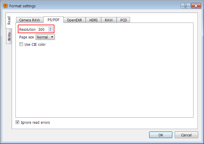

In the Viewer (not Browser) File > Format settings... :lpkalin22 wrote:Hello! When I convert EPS files into JPGs using this software, it makes the files super tiny and pixelated. I've tried using actions to change the DPI and image size, but this only allows me to make the artwork larger (not any clearer). Any suggestions? Thanks so much!!
Increasing the DPI at which the images is rasterised when the file is opened should be the answer...

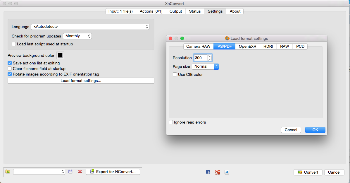

Thanks cday! I had actually tried that as well...I think. My menu looks a little different, but I had changed it to 300 here with no luck! :/

Your menu looks different in part because in my haste to reply quickly I inadvertently posted for XnViewMP, but you have evidently found the equivalent setting in XnConvert!lpkalin22 wrote:Thanks cday! I had actually tried that as well...I think. My menu looks a little different, but I had changed it to 300 here with no luck! :/

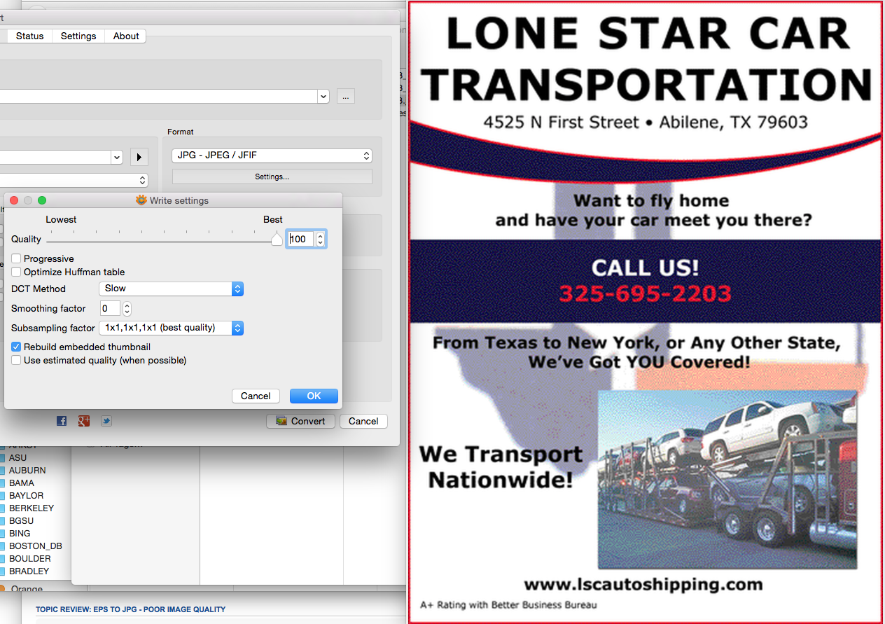

The hasty reply was much appreciated!! Sadly, it does not seem to have made a difference. Just found the settings menu for the JPG output format which has helped the quality a little but still didn't get me to the correct size. So I put in an action to resize by 200% which has therefore decreased the quality again. Darn! Here's a shot of the JPG settings and a sample EPS to JPG converted file...
