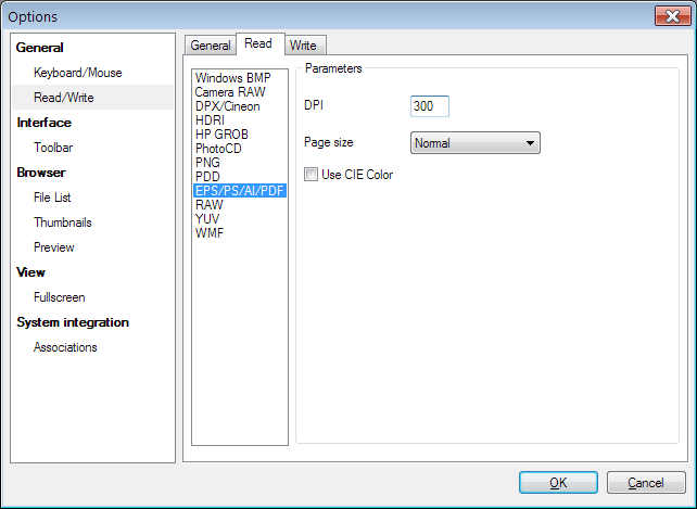

If you are using XnView Classic you need to install Ghostscript 32-bit even if you are using Windows 64-bit, and then increase the DPI value used to rasterise the input image from the default GS value of 72 to a higher value:

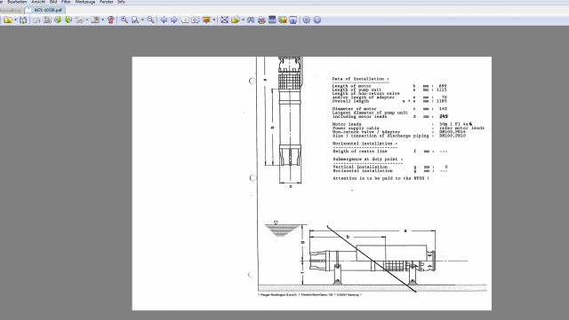

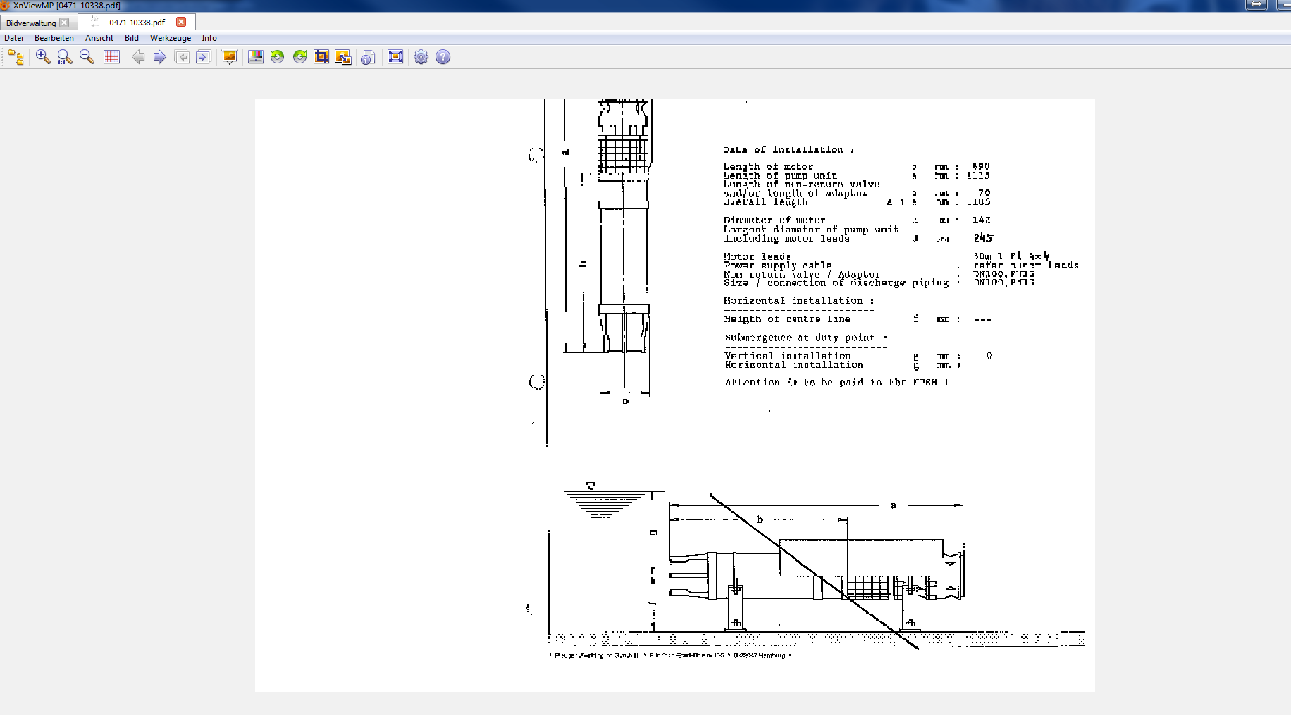

All scanned PDF documents are shown cut. It doesn´t matter if this are landscape or protrait format documents.
Only with PDF documents.
I send you an example document. If you open the document with Adobe Reader DC the document will shown correctly. If you open the document with XnView the document are shown cut.

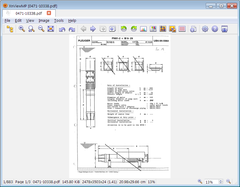

However, the file opens normally and all pages can be viewed using XnView MP, but note that the Ghostscript version installed must match the x32 or x64 of the version of the program you install. The DPI used is also set in the Viewer in File > Format settings...
Edit: The problem persists even with Tools > Options > General > Read/Write > General tab -- Ignore read errors checked.

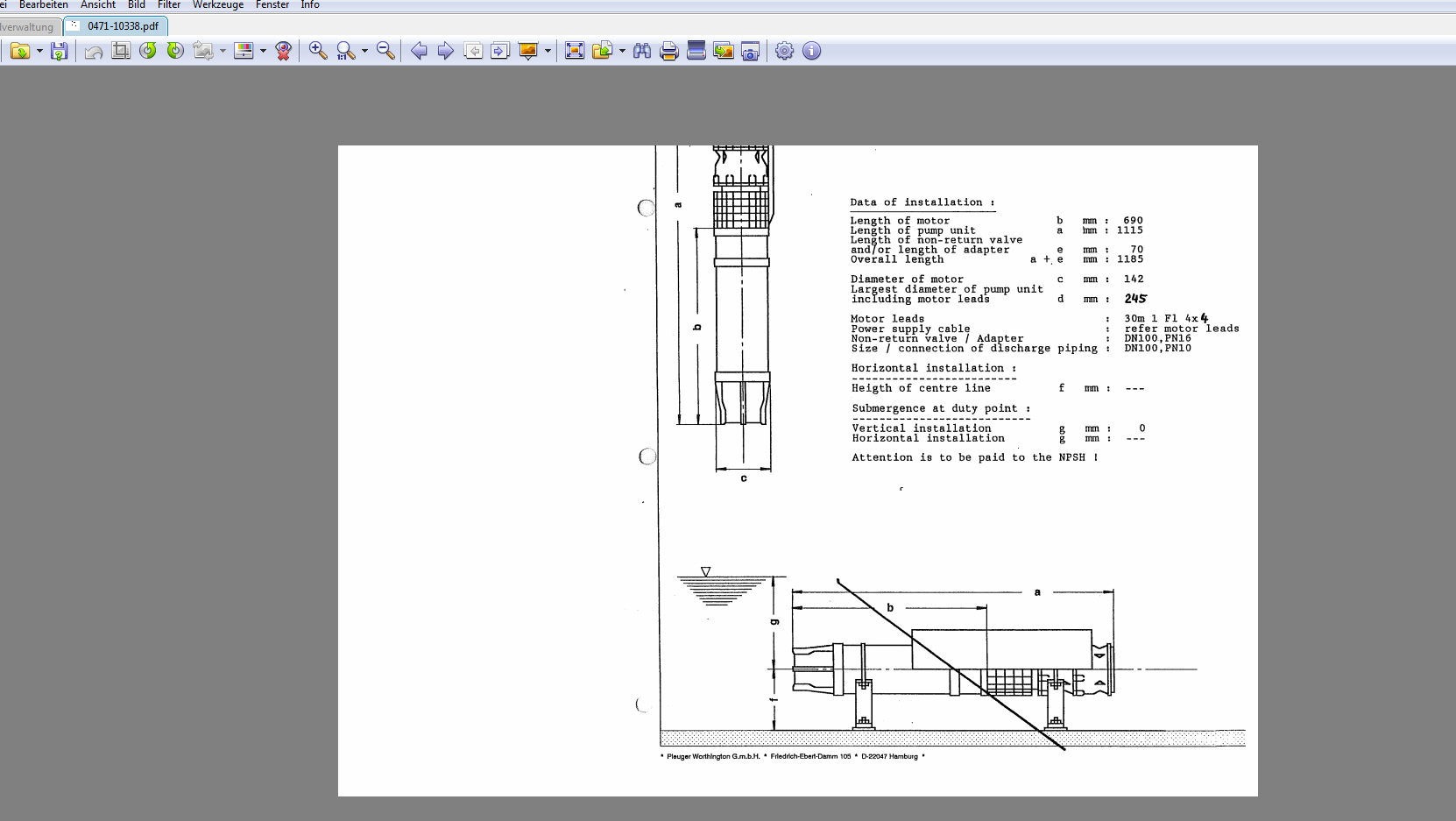

We have installed XnView version 2.35 (fullversion) and GS 8.54, both 32 bit.
And we can open the PDF document in portait orientation but we can´t see the whole document.
Then I installed XnView MP 0.79 x32. The same, I can open the PDf document in portrait orientation but I can´t see the whole document or drawing.
