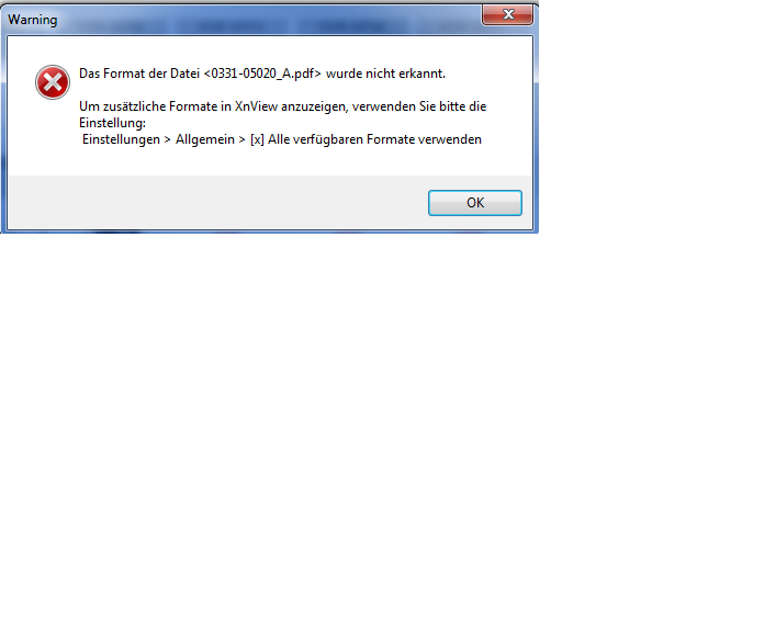

some of our PDF files can´t open, we get the error message: The file format is not recognized.
We have installed ghostscript and a few PDF files could be opened.
Can you help us?
I attached the error message (but in german).
PDf files can´t open - The file format is not recognized

Re: PDf files can´t open - The file format is not recognized
Im found the mistake.
All on a network drive saved files get the erroe message. If I copied the files on my local desktop, I can open the files.
But why it is so?
But why it is so?
Okay, we have found that the files the can´t open are saved in a folder with umlauts (Ä, Ü, Ö).
But not all PDF files. Some files we can open inside these folders with the umlauts.
Can you please help us? Because we can´t change the folder names. An other program has saved the path with this folder names.
- Posts: 4623
XnView Classic doesn't support Unicode characters, but you should be able to open the files using XnView MP...MENCK wrote:Okay, we have found that the files the can´t open are saved in a folder with umlauts (Ä, Ü, Ö).
I installed XnView MP, but the same Problem.
Error opening file.
Error opening file.
If I tried to open the files the second time it works.
Can we use XnView MP with the same license like XnView?
In XnView Classic you could try Tools > Options > General > General tab -- Ignore read errors as XnView software is sometimes less tolerant of slightly malformed files than other software...MENCK wrote:I installed XnView MP, but the same Problem.
Error opening file.
Otherwise, could you upload a file, although possibly the problem is related to the path rather than the file -- you could try opening the same file in a path not using Unicode characters?
Oh no, I mean that we can open the files with XnView MP not XnView. XnView MP works.
Thats why we will use XnView MP in the future.
I hat already written that we can open the files if we copied the files in an other folder. But we can´t use other folders for these files. And we can´t rename the folders.
Thank you for your help.
No problem.
We can use XnView MP with the same license. Thank ya.
