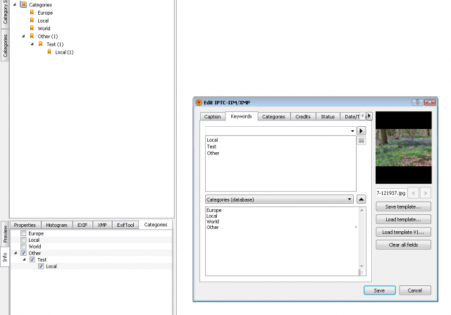

No photo has any categories defined. I select one photo and click on category Local (option "Automatically apply parent keywords" is set, so categories Test and Other are now auto-selected).

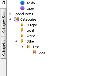

The categories tab and the dialog to Edit IPTC/XMP now look like this:

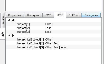

Please note that the Edit dialog shows no hierarchical tags although they are visible in the XMP tab:

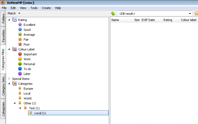

Now I copy the image file back into the original directory; I have set the option to "Import XMP subject or IPTC keyword to DB categories". After this, sometimes the categories in the Categories tab are updated and sometimes they are not (it is not clear what triggers this). What is worse is that Categories Filter shows the categories as expected:
but when I then select one of the categories (here Local) the image is not shown in <DB result>. This is reproducible and happens even after a restart.

jonha4711 wrote: Please note that the Edit dialog shows no hierarchical tags although they are visible in the XMP tab:
yes right, there is no way to show hierarchical keywords in 'Edit IPTC'

xnview wrote:We can see that Other, Test & Local has a picture file. If you click on Other or Test, same thing??
I can't reproduce, it always works for me...
I can click on any of those categories and the image, though existing, will not show as <DB result>. Strangely, this is entirely reproducible here. If you do have some ideas as to what may cause this discrepancy I can test further.
