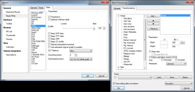

i resize it 200% using XnView Batch Processor with this settings

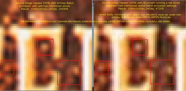

After it i export this settings to NConvert .bat file and resize Source file 200% using this .bat. that's what i get

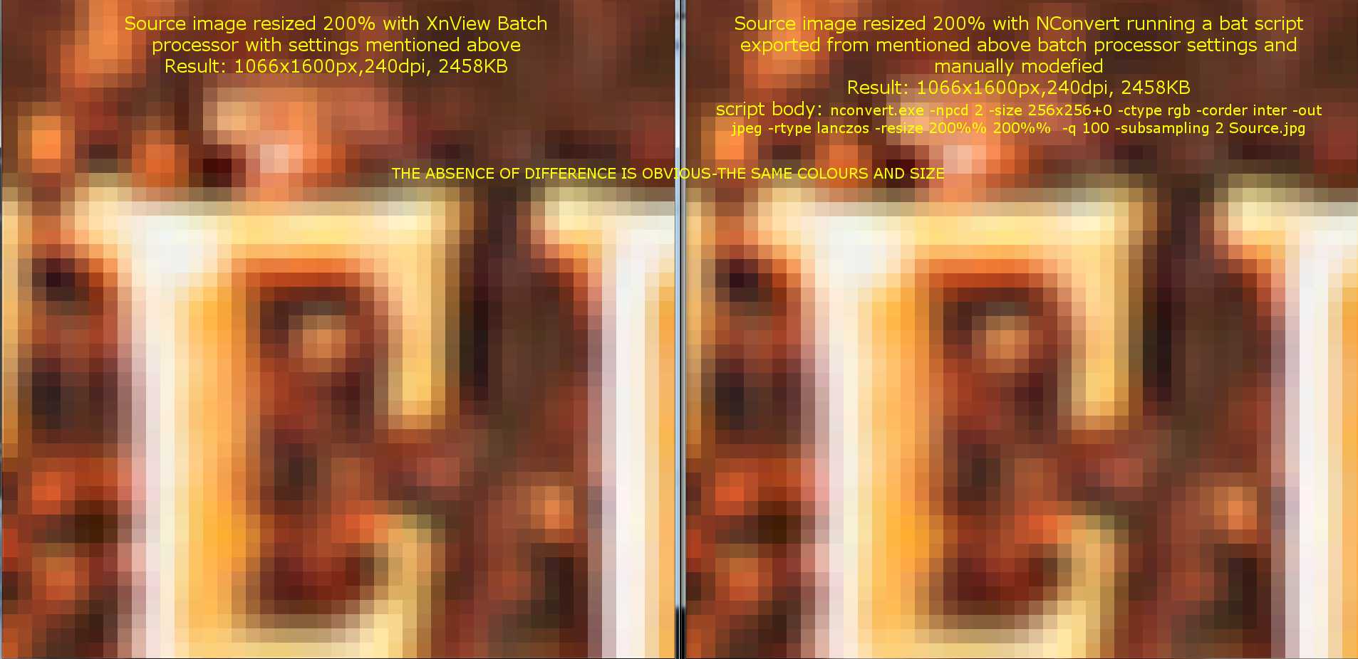

After it i manually modify this .bat file, convert Source.jpg using modified .bat and thats what i get
Does it mean that XnView v.2.36 that i use still makes wrong scripts where absence of -q means -q 100 by default when it's -q 85 in current Nconvert?

XnView has an option To Export It's Batch Processor Settings In To .bat file for NConvert using. If i set it as shown on at the first picture with the quality level 100, i expect to see code in the result .bat file like this when i press export
instead of this i see
and of course when i use this last one .bat i get picture of 85% quality of original, when i want to get 100% quality, as it set in settings

P.S. XnView 2.36 was installed clean, after installation settings under tools-options-write-jpeg was set as on the first image, then restarted
nconvert -npcd 2 -size 256x256+0 -ctype rgb -corder inter -out -q 100 jpeg *.jpgCode: Select all
nconvert -npcd 2 -size 256x256+0 -ctype rgb -corder inter -out jpeg *.jpgQuestion-Do i need to modify manually scripts generated by XnView, or XnView needs to generate PROPER scripts according to it's settings? Or-Why XnView seted on 100% quality generates 85% quality scripts?
