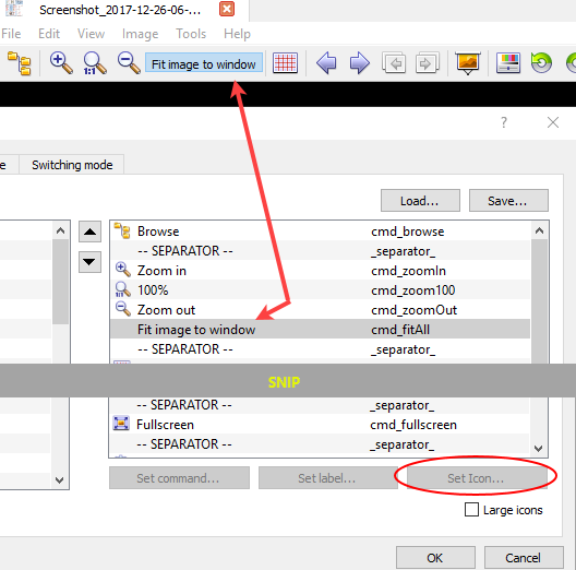

I just want to add an icon to the cmd_ftAll toolbar (instead of the text 'Fit image to Window'.
Is there an easy way to add an icon - if not, well, I leave it this way then.

I've put cmd_fitAll.png and cmd_fitAll.ico into the UI\ and UI\icons-48\ sub-directories of MP v0.80, but the icon won't show up on the toolbar button for Fit image to window | cmd_FitAll.
Set Icon... is grayed out.

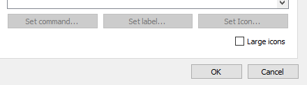

That aside, it seems I can't set any icon at all...(?)
What ever I select, the set icon remains grey.

Still not fixedmrwul wrote:That aside, it seems I can't set any icon at all...(?)
Please give this workaround a try:
- Make a backup of \XnViewMP\UI\toolbar.ini.
- Use a text editor to replace the contents of \XnViewMP\UI\toolbar.ini with the following “code”:
[Toolbar-48] folder=icons-24 size=24 - Create a new folder \XnViewMP\UI\icons-24\.
- Place the 24×24 version of zoom-fit-icon.png or any other 24×24 PNG into \XnViewMP\UI\icons-24\ and rename this image to cmd_fitAll.png.
- Start XnViewMP and go to Tools → Settings... → Interface → ToolBar.
- If you haven't already done so, add a button for Fit image to window | cmd_fitAll to the toolbar of Browse mode and/or View mode.
- Activate Large icons.
- Save the changed settings and restart XnViewMP.

Thanks for the screenshot, mrwul! Let's hope that this issue will be addressed in one of the next releases so we won't have to resort to this workaround anymore.

It has been 2 years, nothing is fixed and not modified. Even this workaround no longer works, I'm tired of seeing huge text buttons, the place of the icons.
