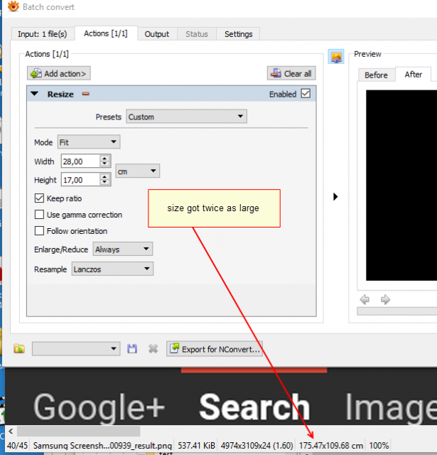

Have spent a lot of time figuring this out myself. Many attempts, many tools.
Give up.
Anybody here who can help please.
I have a lot of screenshots that need to be converted to
width say 28cm
height say 17cm
this will fit A4
the results can later be combined into a PDF file.
How to do this?
I tried with XnView nConvert
but the file became larger .. instead of smaller ..
How to set what/where..??
Many thanks!

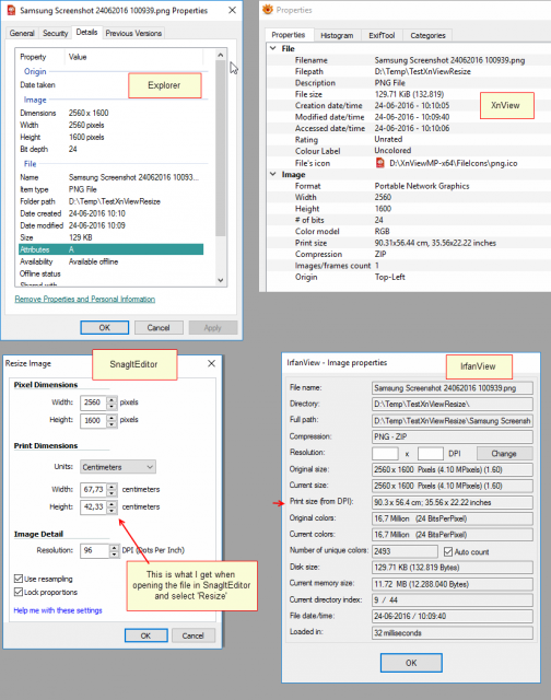

If your aim is to print the image(s) yourself do you actually need to do anything: if you print from XnView software or a PDF from Adobe software, the print menu has an option to fit the image to the page...
As the aspect ratio of your 2560 x 1600 pixel screenshot (1.6) is different from the aspect ratio of 297 x 210 mm A4 paper (1.414) a perfect fit isn't possible, of course, but software typically offers alternative printing fit options in this case. And as the number of pixels in a screenshot is very low by normal printing standards, you might find that rescaling the image(s) to larger pixel dimensions gives better print quality, but you would have to experiment with that option.

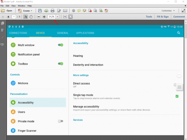

Yes, you are right, PDF is a poor example - sorry.
I can also import the files into Acrobat that will go fine. Though in this example, the window should be resized to 30-40% or so.
But in general, I'd like to be able to reduce the sizes, so I might send them as an attachment, or, for instance, add them to a word document
without having to resize all screenshots one by one.
Width should be something like 25-28 cm and height roughly 17-19 cm - so it falls well within the A4 paper size and is can decently be viewed
on a normal monitor.

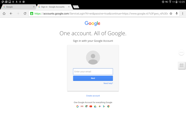

below find an example.
I don't know if the upload is a success, because of the screensize, forum software probably resizes it and maybe also the filesize, no idea...
(filesize is just 154kb)

“Maximum thumbnail width” is currently set to 640 pixels.mrwul wrote: I don't know if the upload is a success, because of the screensize, forum software probably resizes it and maybe also the filesize, no idea...
- http://newsgroup.xnview.com/download/file.php?id=3134&t=1 = 640 × 400 (thumbnail)
http://newsgroup.xnview.com/download/file.php?id=3134 = 2560 × 1600 (full-res)
