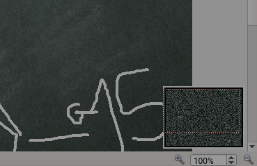

A corruption is seen on the Pan Tool when using the option "Change Color Depth". It happens when you select the 8 bit option and any of the filters on the option box. I have checked against several type of images and it happens on all of them (png, gif, jpeg). This however, doesn't seem to corrupt any file when I save them.

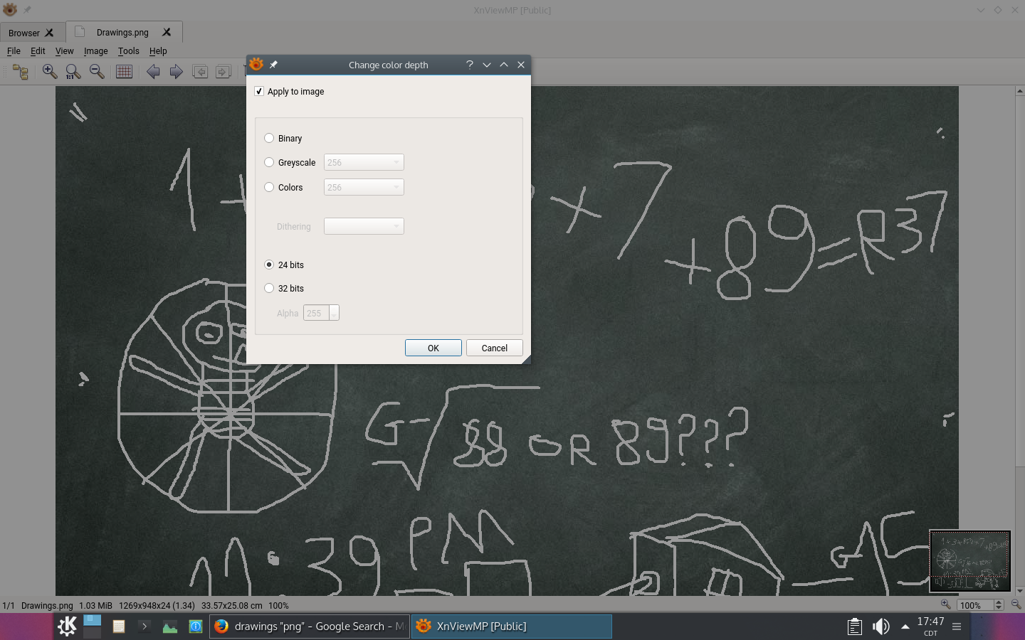

Step 1
file opened
file opened

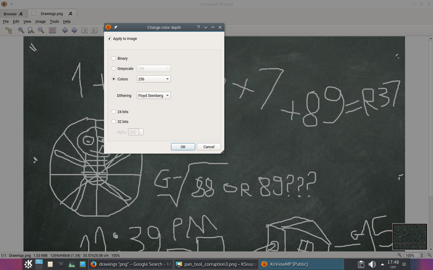

Step 2
changed options
changed options
And the corruption :
the corruption
the corruption

I could reproduce your problem using the following steps:
1. Open a JPG photo
2. Select Image » Adjust » Enhance colors
3. Set "Saturation" to "-100" and apply with "OK" button.
(Your image is a greyscale image, now).
4. Zoom into the image. XnView displays the Pan tool in the bottom-right corner. The image in the Pan tool looks fine. (correct).
5. Select "Image » Change color depth..."
6. Choose "Color = 8 and Dithering = Floyd Steinberg.
7. Confirm with "OK".
(Your image is a dithered image with 8 colours, now)
Actual result: The image in the Pan tool looks very messy and full of pixels.
Expected result: The image in the Pan tool should show a miniature of the actual picture.
Until now (XnView MP 0.84), XnView MP doesn't use high quality zooming for the pan tool. For this reason dithered black&white images look very ugly in the pan tool.
Suggestion/Bug fix: High quality zooming should be applied for Pan tool.
