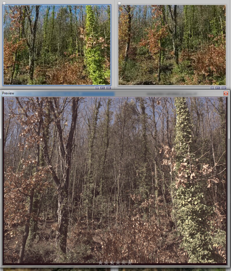

m.Th. ([url=http://newsgroup.xnview.com/viewtopic.php?p=118666#p118666]Raw preview of ORF leads to green image[/url]) wrote:Perhaps you must know that the 'preview' is a 'doctored' image of the actual RAW data. Let me say it again: When you look at the embedded preview you look at other image than the actual RAW image. Usually some curves, increased contrast, saturation, sharpen etc. are applied.
See bellow the difference between the thumb in top-left and the actual raw data (bottom) of the same file of a high-quality digital back (Hasselblad H4D). The purpose of the raw file isn't to look 'pretty' but to keep as much information as possible. That's why, generally, in order to keep as much as they can from the dynamic range of the light which hits the sensor, the colors appear dull, lacking contrast (especially if the files use Adobe RGB color space). If you do some PP the image will look indeed prettier, but this isn't the purpose of the RAW data.
There are brands/cameras known to do enough PP before saving the thumb in the Raw file. Perhaps that's why Photoshop's Camera Raw plugin has a special tab (page) dedicated to presets for each camera model they support which mimic the PP applied by the camera on the Raw data. Hence if a beginner wants to see his Raw "exactly like he saw it in Explorer", he can go on that tab and choose "Normal", "Vivid" etc.
