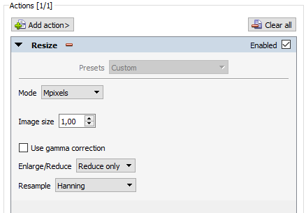

I'm trying to reduce image that are > to 1 MP. However, there are already multiple images < 1 MP in the input. And when the batch goes on, those images size stays the same (height and width - so far so good) but the file size changes... So why is it so ?
See, the example below : from 61,1KB to 35,2 KB. I tried the batch on jpg and png. Also, sometimes the filesize increases, and sometimes it decreases.

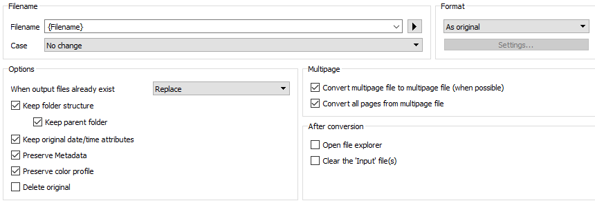

In batch convert file are always resaved, resize action is not always executed...

Thanks for your answer. However, why would filesize change (up or down) if resize isn't executed ? Is image quality still the same ?xnview wrote:In batch convert file are always resaved, resize action is not always executed...

perhaps the compression mode for png is not the same

I did a little test with the 2 PNGs (the original one and the one that got copied with XnConvert). I converted them to BMP with XnView then I did an hex comparison of the 2 image files. The BMP were exactly the same at the hex level. So I guess you're right and, for PNGs, it's just a matter of compression.
However, what about JPEG ? I did the same test, and the BMPs were different at the hex level.
Have you another wild guess for that ?

PNG is lossless compression, jpeg is lossy compressionCheeseDurger wrote: However, what about JPEG ? I did the same test, and the BMPs were different at the hex level.
