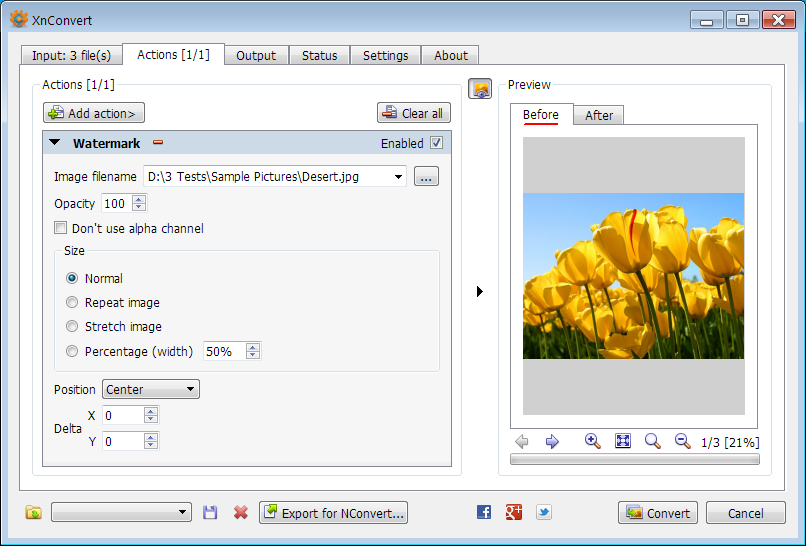

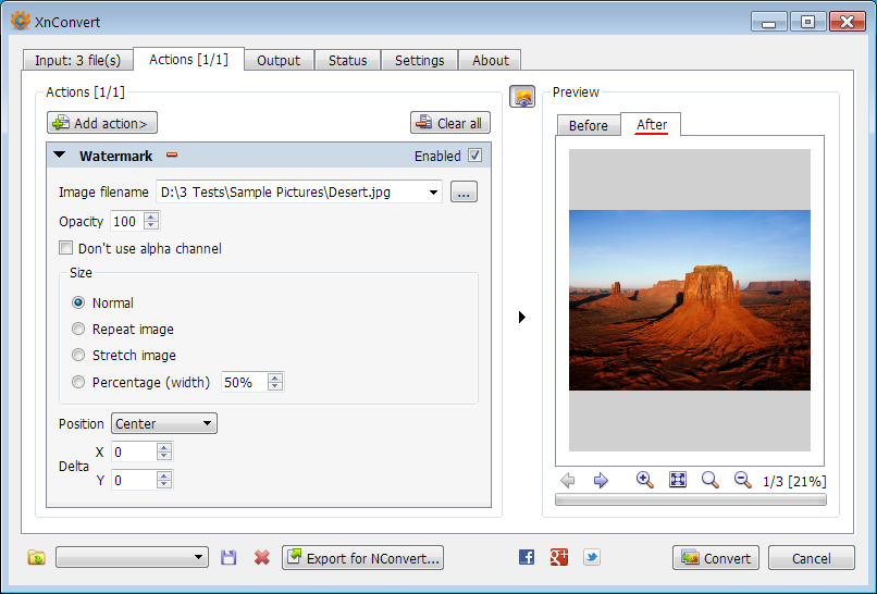

I think this can actually be done very easily using XnView software
Solution: use Batch convert to watermark the images in the folder of images to be changed with the replacement image:
For example, using XnConvert:
As the pixel dimensions of the video frames will all be the same, the desired image is in effect substituted for the original images.

cday wrote:Solution: use Batch convert to watermark the images in the folder of images to be changed with the replacement image:

nice, this worked, especially because they where not equal numbered !!!
Thank you very much !!!
