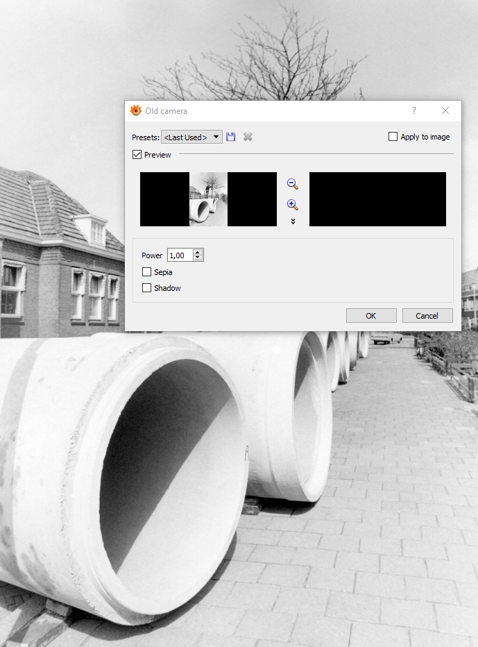

On the b/w images Image->Map, both 'Automatic' doesn't work, I see no differences.
Old camera, I don't know - the preview remains black.
The only thing I can do is use Image->Levels and shift the top slider from left (0) to right, to say 30-40, then some contrast is added.
But regretfully that is not a 1-click solution, like the 'Automatic Levels'.

- Posts: 4601
Re: Image->Map-Automatic Levels-Save in a batch
The idea would be to see if you can find Levels settings that improve images in general, and then use those settings in Batch convert ...mrwul wrote:The only thing I can do is use Image->Levels and shift the top slider from left (0) to right, to say 30-40, then some contrast is added.
Could you upload the actual image above, rather than the image open in XnView MP?
