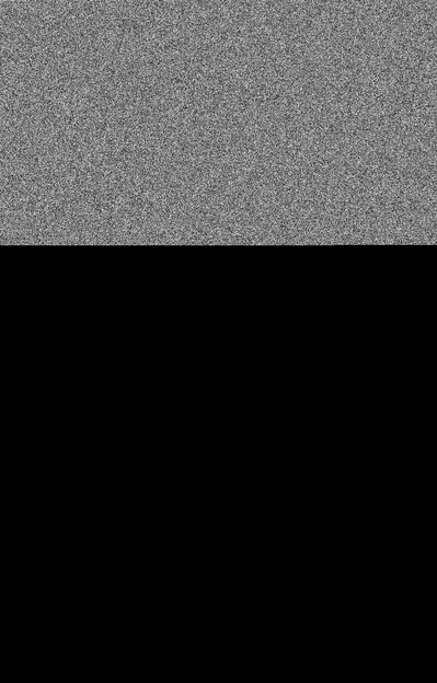

I've downloaded your DICOM file to check but displaying thumbnails or opening it failed:
Your DICOM file has no file extension, so with default settings XnView will not be able to recognize the file format unless you deactive setting "Recognize only by extension" (in Tools > Options | Browser > File list | "Misc" tab).
After unchecking the setting "Recognize only by extension" a thumbnail is displayed and I could open the DICOM image, but it didn't look right (bottom part is just black, top part looks like a random mix of black and white pixel): Perhaps a variation of DICOM format that isn't supported by XnView, yet?

- Posts: 48516
Re: Dicom medical imaging files
this dicom file is jpeg 2000 based, so currently not supported...
- Posts: 8704
Thanks for checking. Would it be possible to display a detailed error message?xnview wrote:this dicom file is jpeg 2000 based, so currently not supported...
