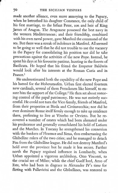

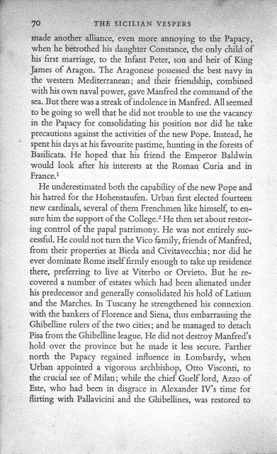

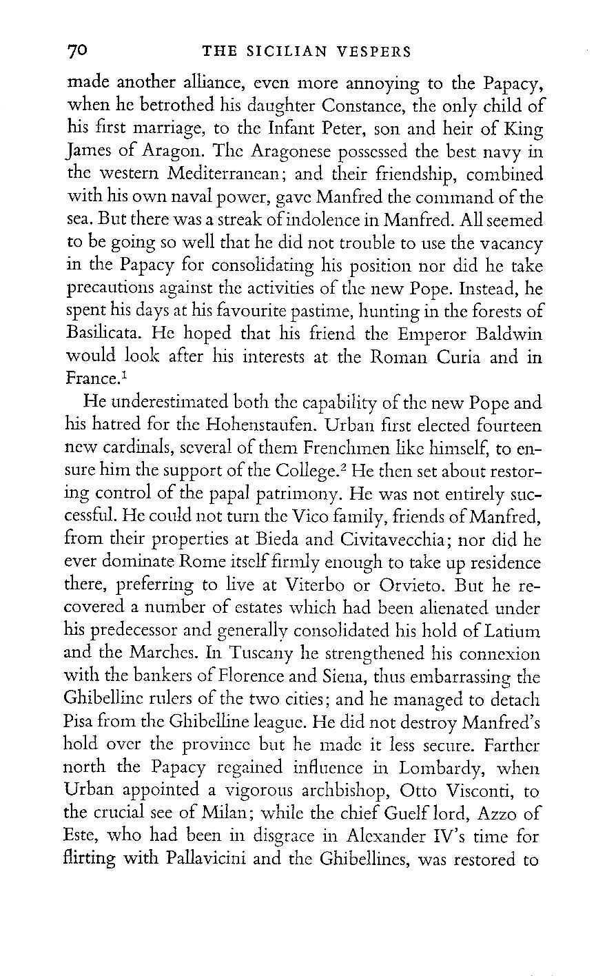

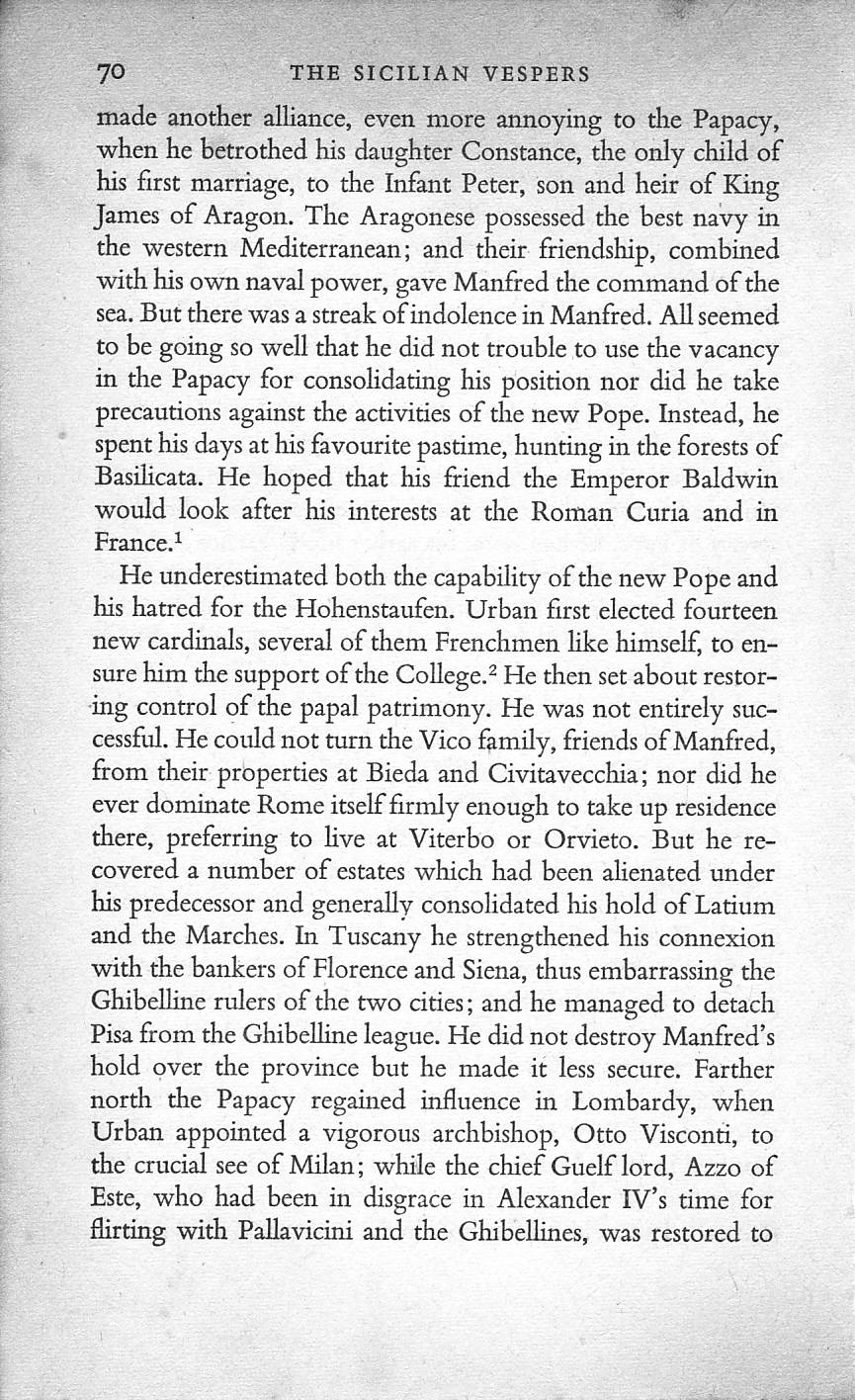

I have scanned the pages of an old paperback of mine. The results are grayscale, 200dpi jpegs. Whilst the results are readable their general appearance leaves something to be desired; there are large areas of light brown (is this what is called foxing?). Is there any way of "whitening" the pages. Pushing up the contrast in Map>Adjust to the maximum of 127 does whiten the pages but it also markedly decreases the quality of the individual letters to such an extent that the original is preferable.
Examples of original (70A) and increased contrast (70B) are attached. Is there anything else I could try?

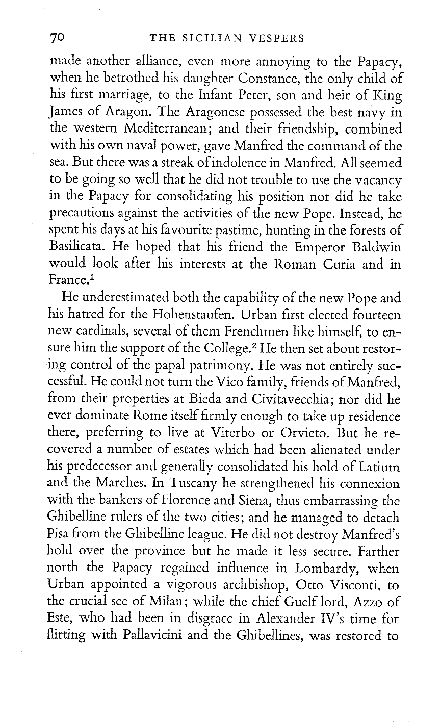

I find a Levels adjustment on a grayscale image [as yours already is] is generally a good start:
I used XnView MP which allows the white point, black point, and also the gamma value to be adjusted directly, in my quick test I used these values which you may be able to improve on:
Black point = 55 ; Gamma = 0.30 ; White point = 130.
I also took the chance to erase two gray areas at the top of the page by, very quickly, copying and pasting a small area of clean background over the affected areas.
The limit to what can be achieved when enhancing a book page image like yours is ultimately set by the evenness [or rather unevenness...] of the illumination and the lower than ideal DPI value of 200.
Edit:
Not obviously a significant improvement on your result...
You might also look at reducing the colour depth to black and white (1-bit): although lower-DPI text generally degrades noticeably, that isn't particularly apparent on the above images, and there can be a large reduction in file size when saved as a TIFF with 'Fax' CCITT G4 compression, if that could be useful, 26kB for my image above. In general, though, the grayscale image will be better unless the scan DPI is raised significantly.

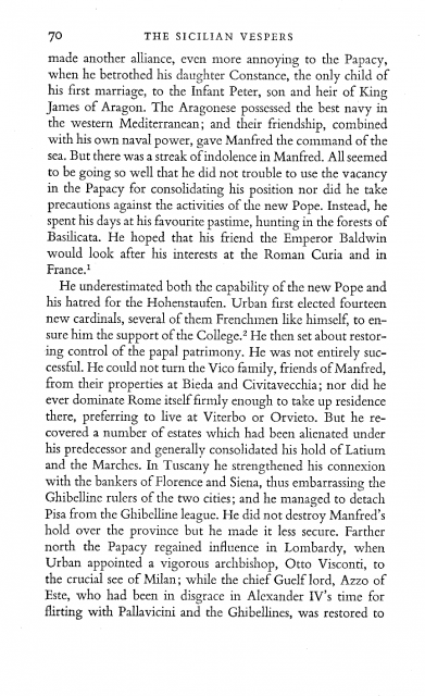

Here's my shot at it:
  1. Image » Map » Posterize... » 2
  2. Image » Convert to Binary » Binary (No Dither)
  3. File » Export... » TIFF » CCITT G4
p136115.tif
EXIF metadata is preserved.
(26.98 KiB) Downloaded 180 times

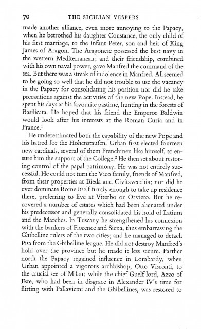

  1. Download George Fournaris' High Pass Sharpening filter.
  2. Extract the content of pphps.zip to the folder where you keep your Photoshop-compatible plug-ins.
  3. Open 70A.JPG in XnView.
  4. Increase the color depth of the greyscale image with ImageTrue Colour.
  5. Go to FilterAdobe Photoshop Plug-In...Photo-Plugins, select High Pass Sharpening... and hit the Start... button.
  6. Apply the filter with the following settings:
    • Range (x10): 150
    • Strength: 255
    • Drop-down list: Normal
    • High Pass view: Deactivated
  7. Go to ImageAdjustLevels...:
    • Black point: 0
    • White point: 72
  8. Reduce the color depth with ImageConvert to Grey256 Grey scale.
  9. Go to EditBackground colour... and choose R255/G255/B255.
  10. Optional: Go to ImageRotateAuto de-skew.
View full-res Image
Result w/o de-skewing

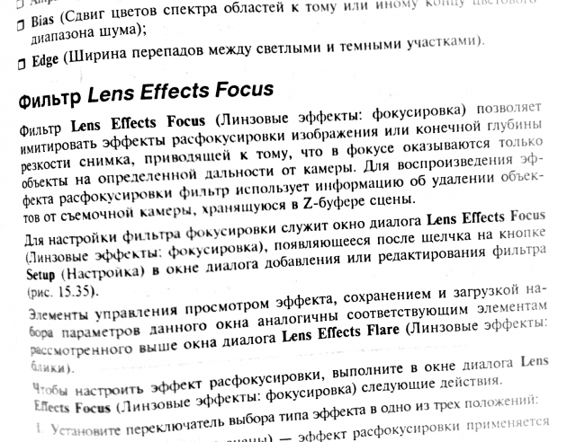

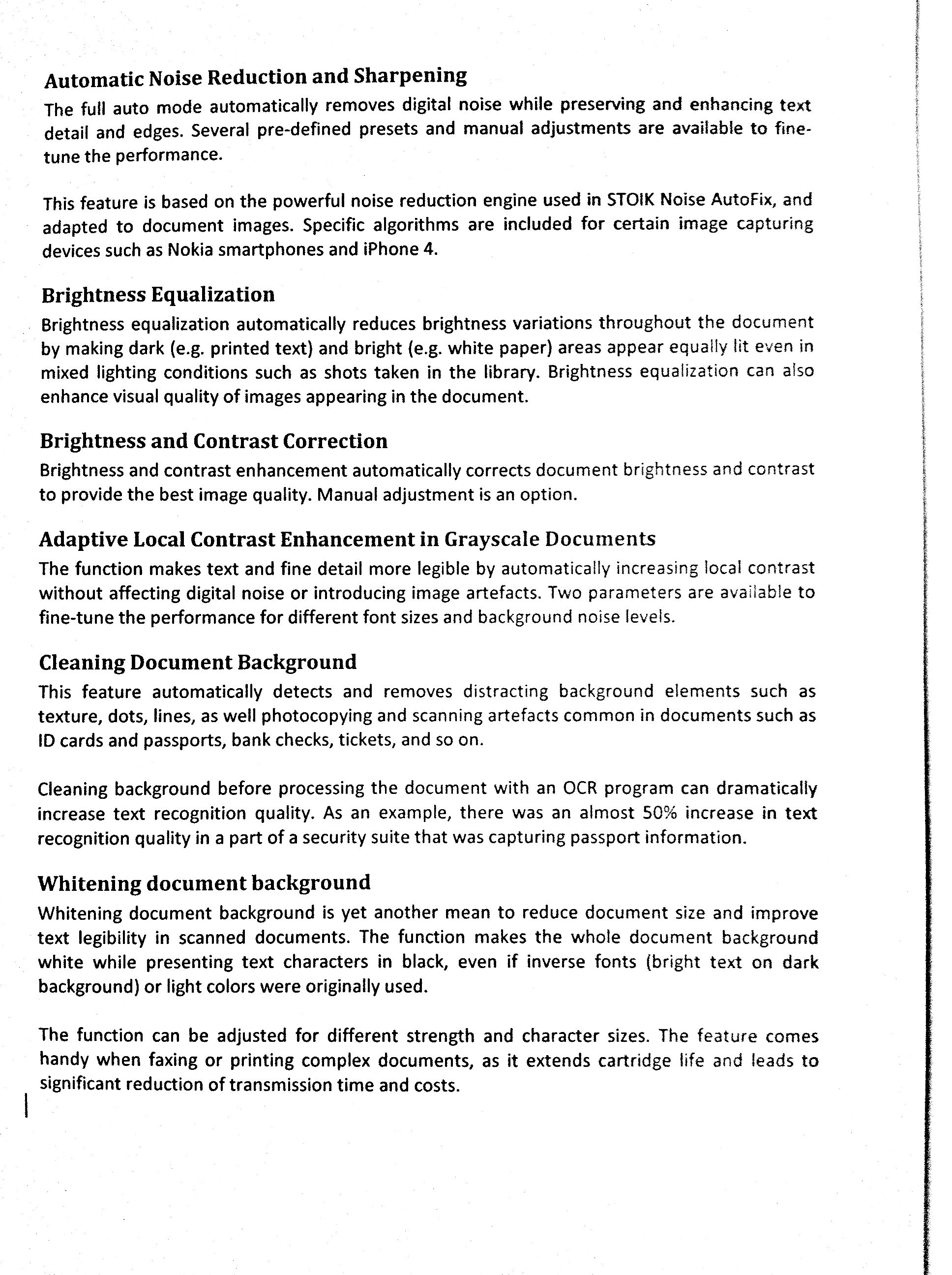

View full-res Image

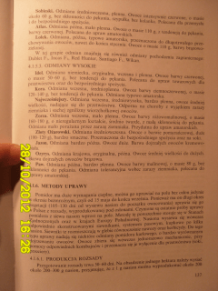

View full-res Image
… and text-from-book-big.jpg (sans Auto de-skew):
View full-res Image
