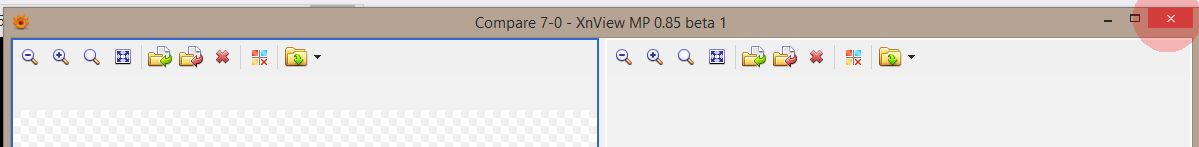

xnViewMP without tabs, select 2 files and click Compare in menu.
Compare window will open (it is not second window together with main appl window as in xnViewClassic , but only Compare !),
there is only one way to close this window - by "X" button on top-right corner. This is equal to - exit xnViewMP.

the 'X' button is the close button for app - Yes, is there any other way to close this window - I think NO.
But I don't press Ctrl- why to press it and what dialog ? I just select 2 files and go to menu>tools>compare or from my toolbar.
Again TABs are NOT in use.
P.S.
Ok - there IS another way to close Compare - by pressing Esc key on keyboard, and in this case Compare window will close and Main window is available as it has to be.
But Pressing the "X" with mouse on Compare = Exit xnView.
Posts: 46426
Re: 0.84: "Compare window" without Tabs
sorry about CTRL key, so without tabs, you have only ESC to close the compare window

If "Esc" closes the Compare window and returns to the browser, why doesn't [x] also close the Compare window and return to the browser?

Only Esc key is closing the 'Compare' window properly (returning to Browser), but pressing [X] button will not return to Browser, it will exit the program - I think this is a bug.
Pressing [X] button on 'Compare' must return to Browser, as it is in xnViewClasic.

tboy wrote:Only Esc key is closing the Compare window properly (returning to Browser), but pressing [X] button will not return to Browser, it will exit the program - this is a bug.
Yes, tboy, I also think that this is a bug (see my previous post).
