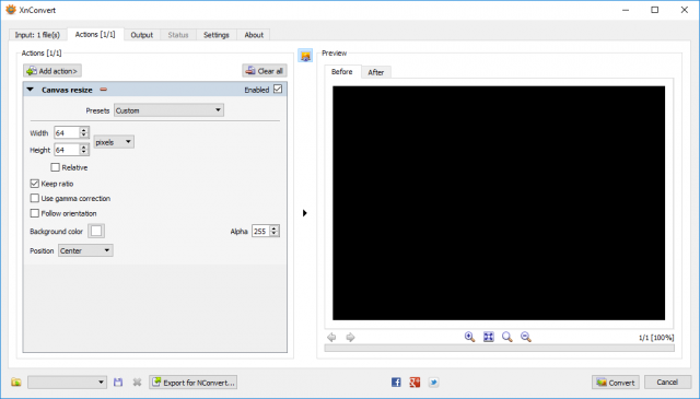

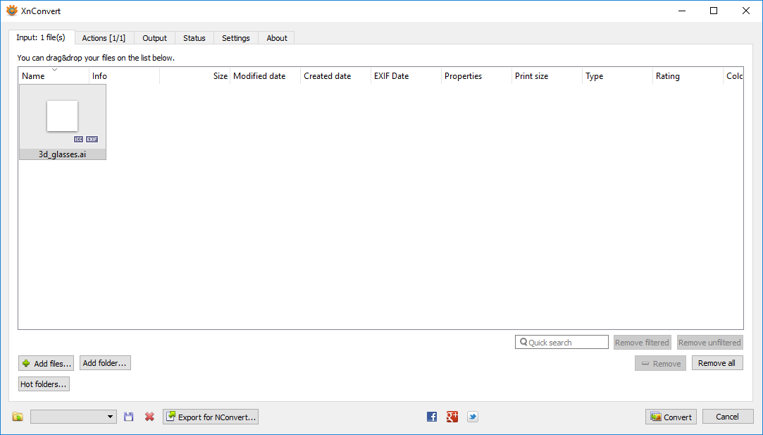

Hello, I'm try to convert a icon set in ai (adobe illustrator) to png, but for XnConveter every ai file is "not a picture".
I have google and found that I have to install ghostscript, but it is still not working, also the "preview" is always a black panel.

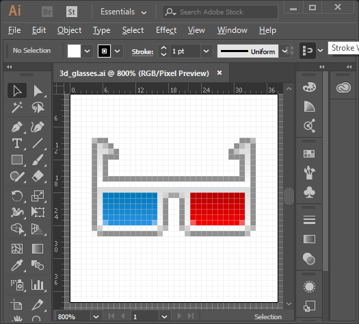

I have attached an ai file as example, am I doing something wrong? Or is the ai file format not supported?
Thanks

Your file 3d_glasses.ai opens in XnView Classic, 'MP and XnConvert [and Adobe Acrobat] as a white rectangle for me, pixel dimensions depending on the DPI value set [in XnConvert in Settings tab > Load format settings...].

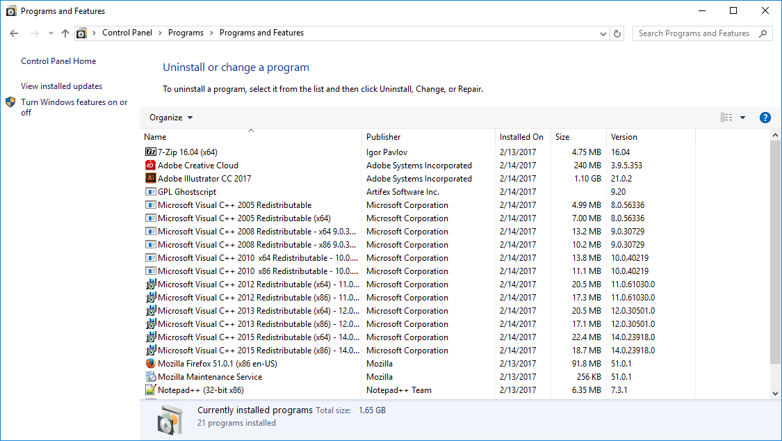

Note that if you are using XnConvert 32-bit on a 64-bit operating system, you need Ghostscript 32-bit installed...

Thanks for the reply, but I don't know how to interpret it, you mean that I can't do anything? That XnConverter cannot convert them?
I can open the icons in AI (Adobe Illustrator), but XnConvert shows always the file icon and the preview is black, by the way I have installed Ghostscript.

Are you using XnConvert 32-bit and if so do you have Ghostscript 32-bit installed?

I have installed the 64bit version of XnConvert ... and I think I have installed the 32 bit version of ghostscript ... I try to reinstall it.

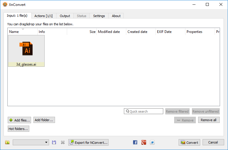

I have reinstalled ghostscript, I think I had installed the wrong version, now XnConvert recognizes the file type but the preview is a white box and converting throws the same error "not a picture"

spamme wrote:I have installed the 64bit version of XnConvert ... and I think I have installed the 32 bit version of ghostscript ... I try to reinstall it.
If you are using XnConvert 64-bit you need Ghostscript 64-bit, you can install both GS versions at the same time if you wish.
Looking at the screenshots in your earlier post, in AI your .ai file is not a white rectangle, so I'm surprised that Adobe Acrobat (XI) opens the file as a white rectangle rather than as in your image. Possibly different .ai file format versions??
The file are a couple of years old, it could be an old format of AI
