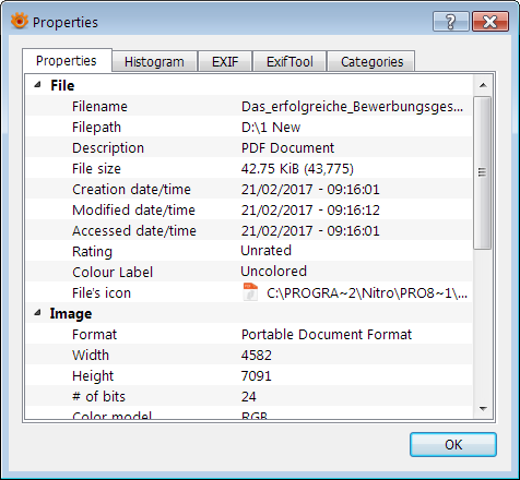

I am not shure if the following is a bug:
I open the following PDF-file with XnView MP: This is a 1 bit b/w document with 72dpi.
But according to XnView MP it is 300dpi, 24bit and RGB. (properties).
Isn't this a bug?
Thank you.

- Posts: 4613
Re: Bug? PDF, properties
Opening your file in a text editor, it appears to consist of vector text (a scaleable outline font as used in a word processor), rather than an image (as produced by a scanner) file... [If you save a Word document as a PDF, it will be saved as vector text.]IxenPDF wrote:I open the following PDF-file with XnView MP:
The DPI value displayed in XnView MP (or other image viewer) is the DPI value at which the file contents have been rasterised when it was opened: in XnView MP that value is set in: Viewer > File > Format settings... > Read tab -- PS/PDF
But there is clearly a problem somewhere, as the text doesn't reproduce well at even 300DPI and does indeed look like text reproduced at 72 DPI...

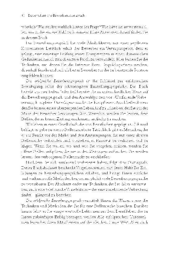

Thank you for your reply.
This is not a vector text. It was produced with gImageReader (https://github.com/manisandro/gImageReader) I use this gImageReader to make PDF's with hidden text from pictures.
And yes, the quality of this picture is rather bad. But do not take care of the quality. It's just an example. I am only interestet in the dpi and other property information. I want to find out the dpi of this picture (and of other pictures).
- Posts: 4613
The file seems to contain font information, but I only had at a quick look and a little knowledge can be dangerous...IxenPDF wrote:This is not a vector text.
OCR the image to a searchable image file?It was produced with gImageReader (https://github.com/manisandro/gImageReader) I use this gImageReader to make PDF's with hidden text from pictures.
A settings problem, or does it really not matter?And yes, the quality of this picture is rather bad.
Images in PDF files have a fixed number of pixels, but DPI is not itself a measure of quality, for example. If the original image was scanned, then the DPI could be determined from the overall pixel dimensions and the print size shown in the file properties.But do not take care of the quality. It's just an example. I am only interested in the dpi and other property information. I want to find out the dpi of this picture (and of other pictures).
Anyway, no reason to suspect a bug in XnView MP...

- Posts: 8704
To me this looks as if someone generated this document using a special font to make the document unreadable.
Open the PDF, Ctrl+A (Select all), Ctrl+C (Copy) and the Ctrl+V (Paste) in Notepad reveals the full text.

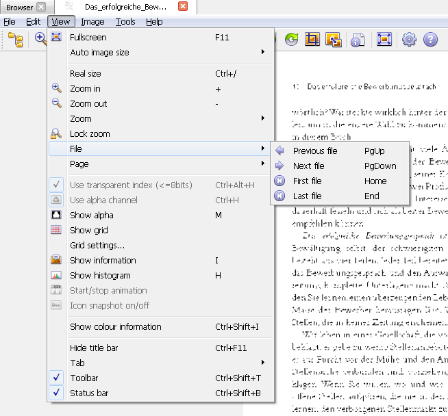

Yes.cday wrote:OCR the image to a searchable image file?
I did not found "Format settings" in this menu:cday wrote: The DPI value displayed in XnView MP (or other image viewer) is the DPI value at which the file contents have been rasterised when it was opened: in XnView MP that value is set in: Viewer > File > Format settings... > Read tab -- PS/PDF

- Posts: 4613
It's in the Viewer: File > Format settings... > Read tab -- PS/PDFIxenPDF wrote:I did not found "Format settings" ...cday wrote: The DPI value displayed in XnView MP (or other image viewer) is the DPI value at which the file contents have been rasterised when it was opened: in XnView MP that value is set in: Viewer > File > Format settings... > Read tab -- PS/PDF
See in the Viewer Edit > Properties...IxenPDF wrote: @helmut:
What I am interested in:
How can I find out the picture settings of a PDF. For example: Width, Height , # of bits, Color model, DPI, Compression? I thought maybe I can get this information with the help of XnView. So I tryed Menu->Edit->Properties in the hope to get this information.
- Posts: 4613
Note that the properties shown in Edit > Properties... are the properties of the image after it is opened in XnView, and so are the pixel dimensions (for example) after the image has been rasterised at the DPI value set in the program as above.
To obtain details of the PDF file itself it would be necessary to inspect the code in the original file opened in a text editor, and refer to the PDF standard, 756 pages long...

- Forum Librarian
- Posts: 6572
- Location: Ref Desk
Re: Wrong PDF properties in XnView?
There are obviously several problems with Das_erfolgreiche_Bewerbungsgespräch-72 s-w extr 11.pdf: One is the font encoding, …
… was placed on top of the selectable text…
… by the OCR software.
