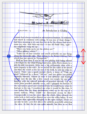

Out of interest, the program ScanTailor widely used for book scan processing has the following interface that allows really quick and easy fine angle adjustment:
One or other of the blue circles is simply dragged to rotate the image, with a sensitivity that makes it really quick and easy to make accurate adjustments.
But refining the sensitivity of the slider in the existing custom rotation tool would be a good start...

Looking at the XnView MP rotate tool in particular, the response to angle changes also seems very slow which makes adjustments even harder. The ScanTailor tool response is almost instantaneous which makes fine tuning really easy.

I fully agree with you, the sensisivity of the slider is too high and using the up/down arrow is too slow but I would not recommend to add "yet another" option in the Settings. This is where both our suggestions joints: I like the Scantailor approach, very close to my proposal Improve the Rotation Dialogue that use the existing grid for horizon reference. It's just a matter of look & feel.cday wrote:the angle adjustment slider is very sensitive, making it hard to make small angle adjustments without using the digital angle display which is slower
This may happen with very high resolution images that requires a lot of calculation on slow machines. We may go for an alternate way: Turn the grid to align with the horizon of the picture and rotate the image accordingly only once the mouse button is released. Alternately, the left/right mouse buttons can be use for purpose as well: Left to rotate the image vs the grid and the other to rotate the grid vs the image.cday wrote:the response to angle changes also seems very slow
