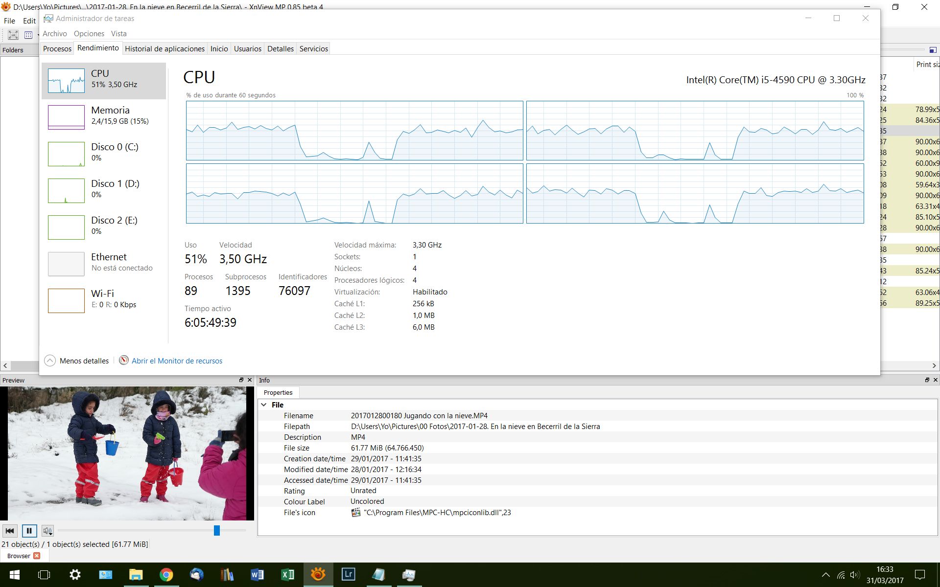

Related bugs/issues about Internal Video player:
- Manually set video position is ignored when you try to re-play H264 files... but Play button doesn't directly work again with H265 files. (At least with H265 mp4 files from my Samsung NX1 camera). When the video finishes you cannot replay it. Play button changes into pause when you click on it but the movie doesn't play again. No matter where you put the position slider. If I want to re-play the clip I have to unselect it/select it again. This issue doesn't happen when the external LAV Filters are used...
- About performance. Look at the attached screenshot. That clip from my NX1 is 1920x1080 HEVC (H265) at 18926 kbit/s. It stutters A LOT but curiously XnView is not even fully using the 4 cores of my i5...
