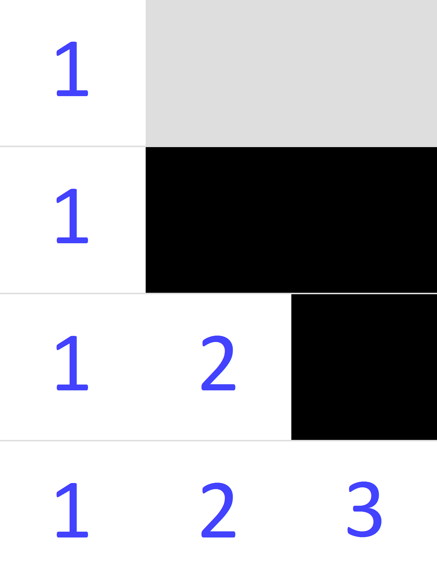

- Posts: 4612
Re: Joining Images in XNViewMP
For what it's worth, although the command line utility NConvert doesn't currently support joining images directly, I can now confirm that NConvert can be used to join images in a batch file, by first extending the canvas and then using the watermark function, twice in this case:
Developing the above 'proof of concept' demo into a batch file to provide a general solution to the problem originally posed would take significant extra time, and I have other things I need to do at the moment...
