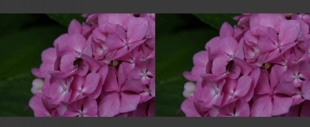

Expected: The two images are aligned horizontally or vertically - depending on your chosen Layout - one next to another. The resulting image is cropped exactly on the border of the new combined image. Something like this:

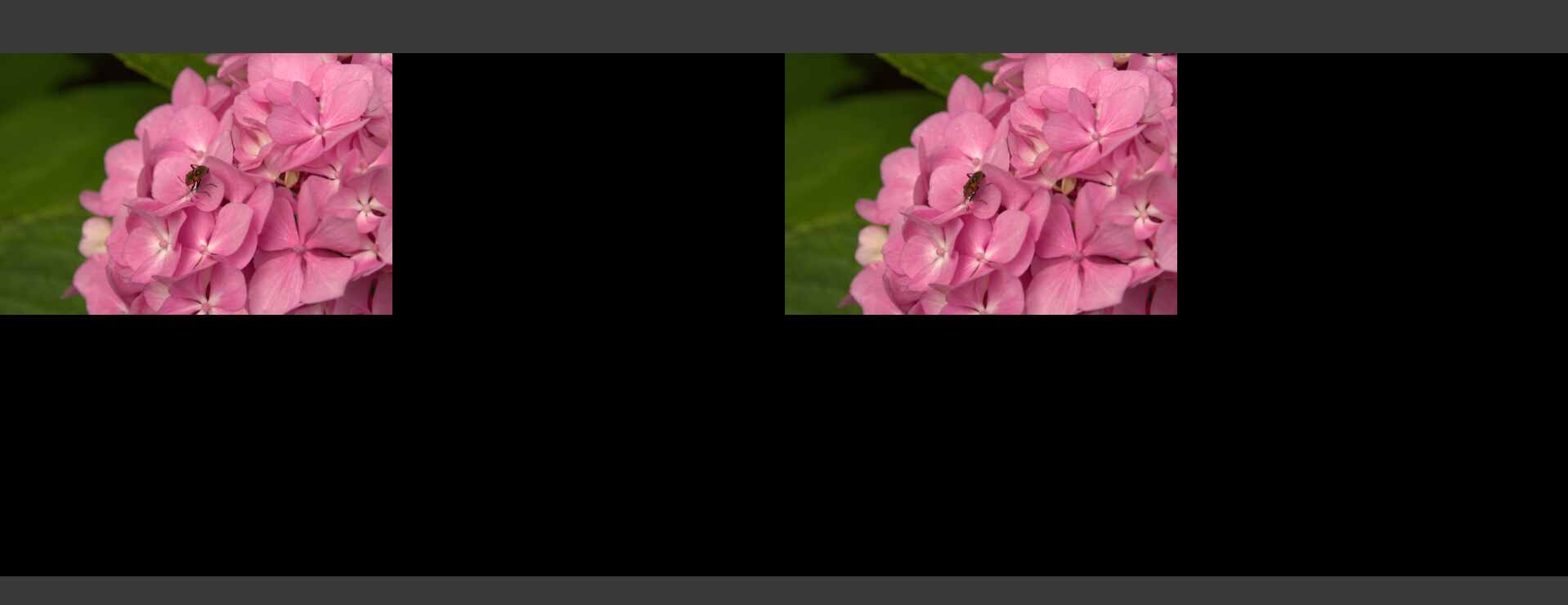

Actual: The resulting image looks like this:
Note #0: The actual joined image has the background black. The gray background is XnView's.
Note #1: JPEGs (at least) work ok.
Note #2: Please see the difference between the reds of the images above which proves that Join Images engine loads raw data in the second case just that it is one-quarter of the original size. I would suggest to stick to the global setting: Use Embedded Preview.

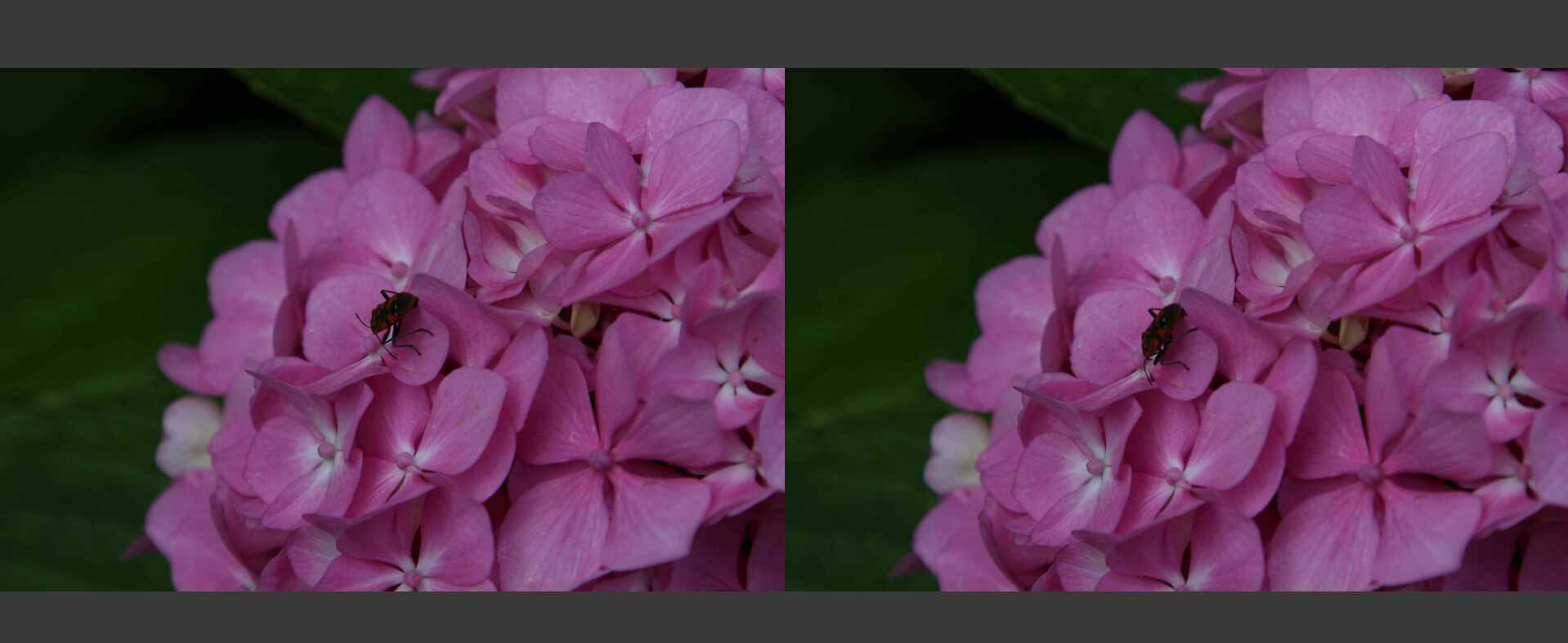

O.k., thank you, I can also reproduce the problem. Issue 1265 is fixed in next version.
Posts: 47856
Re: 0.86: Join Images do not support Raw files
This problem is supposed to be fixed in XnView MP 0.87. Please check and confirm the bug fix here.
