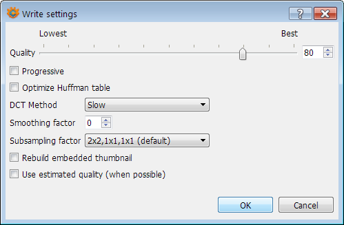

It seems slightly strange that when the output file type is set to As original files can only be saved with the [unspecified] default settings, which may not be settings the user would choose, but I suppose there could be a practical reason for that considering the interface design?xnview wrote:Batch convert load and re-write (recompress) the picture, why you don't use IPTC dialog?
Edit: In the case of JPEG wouldn't it be natural to save using the 'estimated original quality' ?
In practice a user might, as NicoPL does, wish to save the output files with the same settings as the input files, or in another situation wish to save the output files with diferent settings such as higher compression.
I think a simple solution to your issue would be to set the output file type to JPEG rather than to As original which would make all the JPEG Settings... options available:NicoPL wrote:When using Batch Convert to batch edit the IPTC tags, and keeping the format "as original" (therefore "settings cannot be changed"), I noticed a change on the filesize of all my pictures.
It seems strange as the picture is not modified in anyway, only the metadata should be.
I tested a Batch Conversion with NO action at all. And still keeping the format "as original".
That way, the expected result should have been a simple copy of the files. But no, I get the new files with half the size of the original ones.
You have the option there (among other options) to set Use estimated quality to maintain similar compression to the input files.

I tried your idea cday, putting "jpg" as the output format, with "use estimated quality (when possible)" ticked.
Unfortunately it doesn't do anything. I still get an output file of 1Mo instead of 3Mo (the size of the original one).
