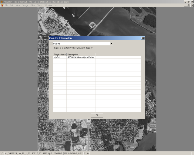

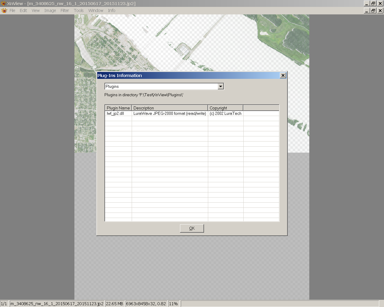

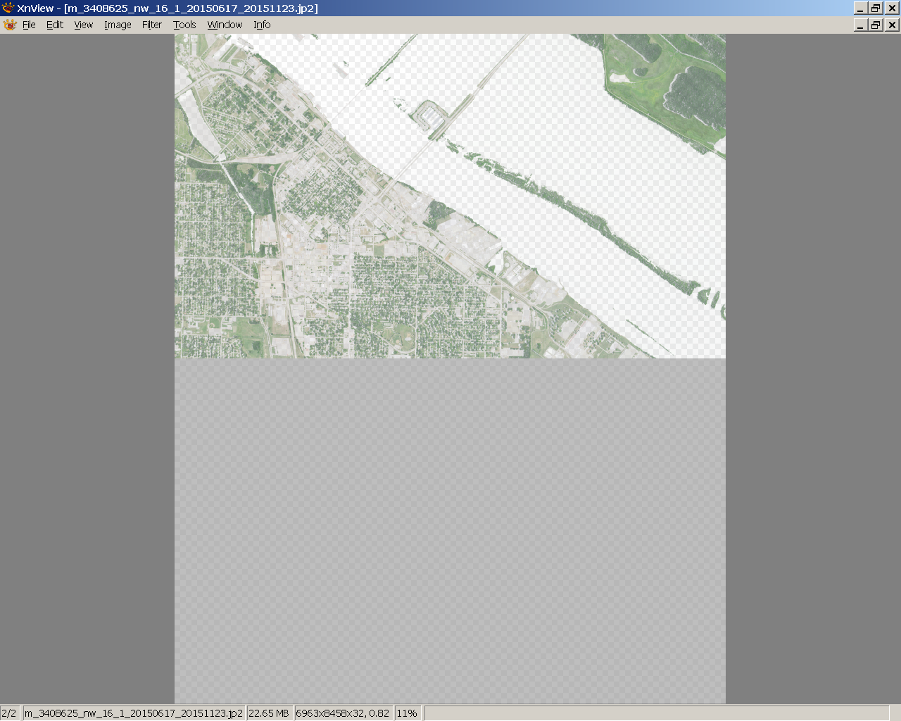

I was able to partially open m_3408625_nw_16_1_20150617_20151123.jp2 with XnView v2.40 by downloading jpg2000_lwf.zip and extracting lwf_jp2.dll to the Plugins subdirectory of my XnView installation. (You might have to remove openjp2.dll and Xjp2.dll to avoid conflicts.)
XnView.com (XnView Classic → Additional Downloads → [url=http://www.xnview.com/en/xnview/#addons]I/O Plugins[/url]) wrote:JPEG 2000 LWF | JPEG-2000 JP2/JPC File format (read/write) (Can only save images up to 4096x4096 pixels)
Posts: 6575
Re: jp2 file doesn't open
Updated screenshots:

I have noticed that when I have both openjp2.dll and xjp2.dll, I can open a small jp2 file with no problems, but when I close the file, I get a spinner for a minute or so.
I got lwf_jp2.dll and got the same image as above with it, just the top half of the image.
But with xjp2.dll, file version 198.0, product version 1.98.3, 224 KB, modified 11/14/2011, 3:29 PM, I still get the format cannot determined message.
