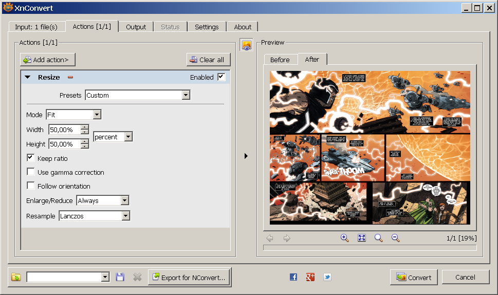

I am trying to reduce the size of a cbz file by cracking it and then reducing the size of the jpegs inside. However, sometimes when I try to shrink the images they end up larger. For instance I set them to reduce to 50% of the original size using Lanczos but they end up being twice as large. So a jpeg that is 4MB in size will end up being 8MB in size after resizing.
Are there settings I can use that will result in a 50% exact reduction in size of all images when I set resize to 50%? Or am I missing something? I would like to reduce a jpeg from 4MB to 2MB without losing much in the way of image quality.

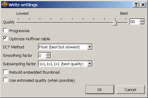

Thanks for the sample. Please try the following settings:
Tec4
Posts: 5
Joined: Wed Aug 30, 2017 9:51 pm
Re: Can someone recommend settings?
Post by Tec4 »
Wow that worked nicely. Although it ended up smaller than 50%. But smaller is actually better so I'll take it. Thank you!

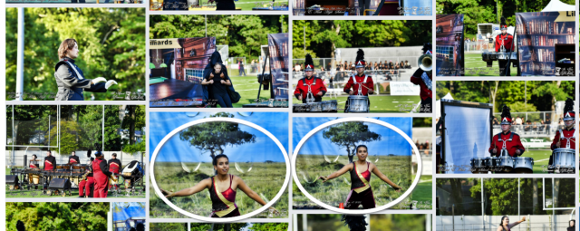

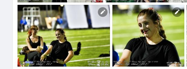

I know my picture are usually width: 6192 and height of 4128 Every time I crop and Image I always try to resize back to those values or as close as I can possible get. I have noticed in the past that after cropping my photos seems smaller (visually) that the ones that I didn't crop (especially after uploading them back to facebook). See example the circled photos

It is important to distinguish between the Resize, the action you need, and the Canvas resize action, which are provided for different uses and may, depending on the settings used, produce different results. In XnConvert the Preview function enables the effect of the selected actions to be seen.
