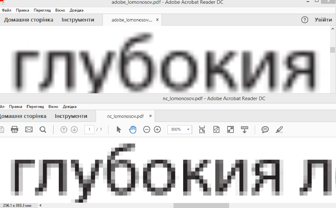

Difference in quality: I created 2 pdf files from one png file (see attachment):
used Adobe Transformer (adobe_lomonosov.pdf) and Nconvert (nconvert -out pdf -o "nc_lomonosov.pdf" "lomonosov.png")
The quality of the file adobe_lomonosov.pdf is better

Yes, you are right, a later PDF version wouldn't directly affect the image quality.
All difference is Antialias in Adobe Transformer pdf document. You can open two documents and see in 400% zoom.
Is it possible created pdf with Nconvert with Antialias like in Adobe Transformer?

Isn't antialiase a viewer function, are you comparing the two output PDFs in the same PDF viwer?Testerr wrote:Yes, you are right, a later PDF version wouldn't directly affect the image quality.

I believe that both of the following settings have to be activated to achieve similar/identical display of nc_lomonosov.pdf and adobe_lomonosov.pdf:
Acrobat User Guide (Viewing PDFs and viewing preferences → [url=http://helpx.adobe.com/acrobat/using/viewing-pdfs-viewing-preferences.html#main-pars_text_30]Rendering[/url]) wrote:
- Smooth Line Art: Applies smoothing to remove abrupt angles in lines.
- Smooth Images: Applies smoothing to minimize abrupt changes in images.

Yes, looking at the PDFs in Adobe Acrobat, I've been thinking that it looks rather like a viewer issue, such as the equivalent of XnView's 'high quality zoom' not being enabled by default...XnTriq wrote:I believe that both of the following settings have to be activated to achieve similar/identical results for adobe_lomonosov.pdf and nc_lomonosov.pdf:
But, independently of the viewer image quality issue, it should be possible to create a PDF file of the original grayscale image using ZIP compression that isn't much larger than the original 61KB file.
