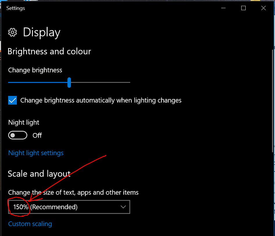

0) Set "Screen Resulution" -> "Font size..." to 150%. (I guess value different from 100%) (attached 150.png file)

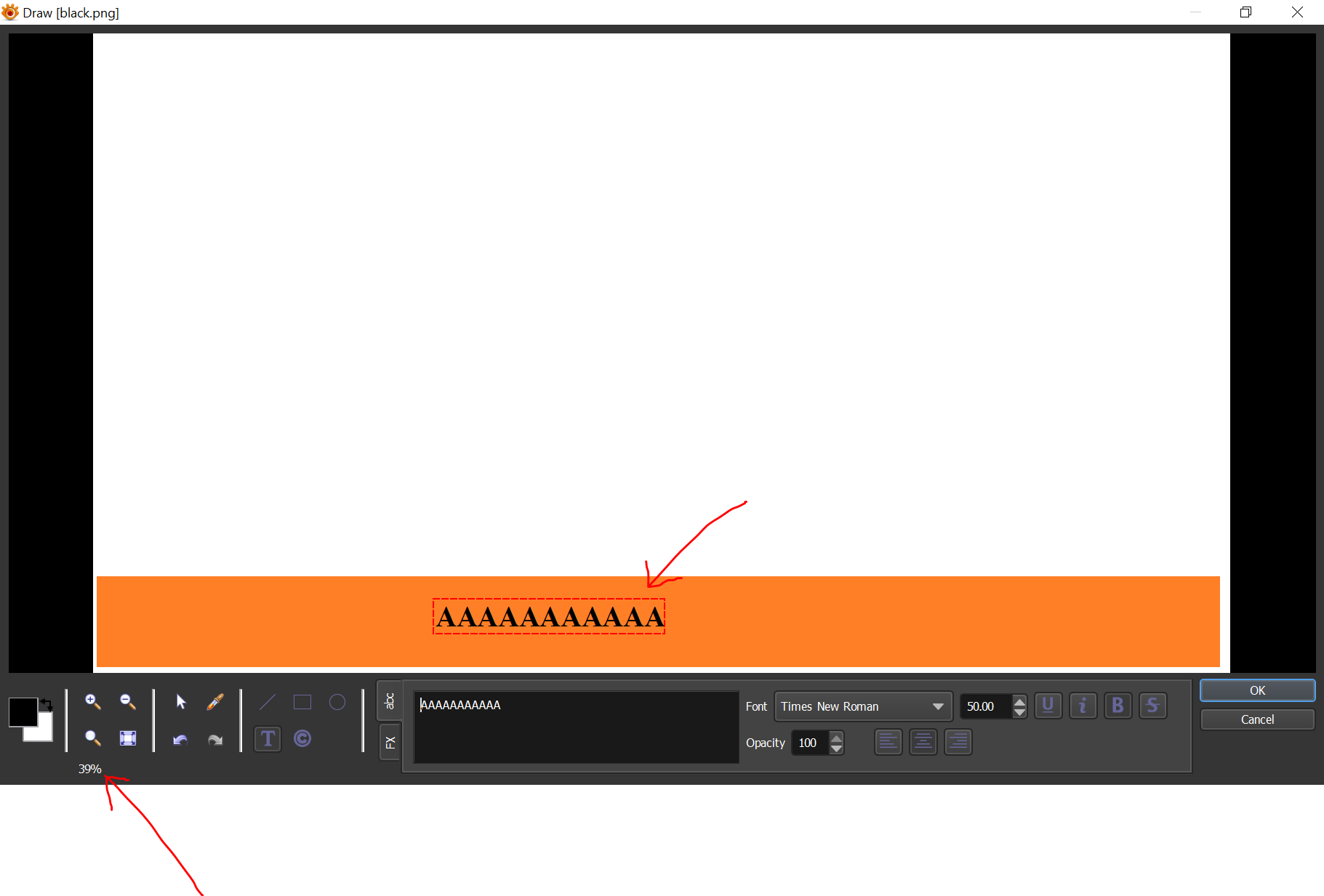

3) Enter the text at the bottom of the screen (attached "Draw.png" file)
4) Accept changes by clicking "OK"

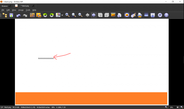

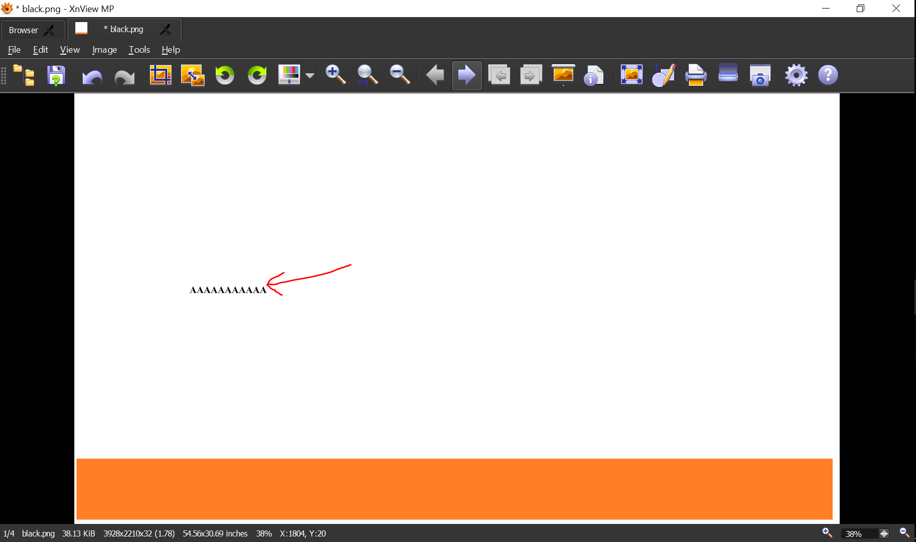

Observed:
Text will appear in the middle of the image instead of botton (attached "AfterOK.png" file)

Workaround:
Set "Screen Resulution" -> "Font size..." to 100%. (attached 150.png file)
