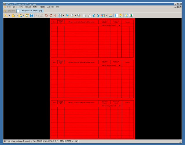

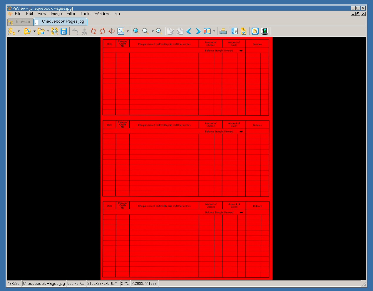

I've attached a couple of screen grabs.

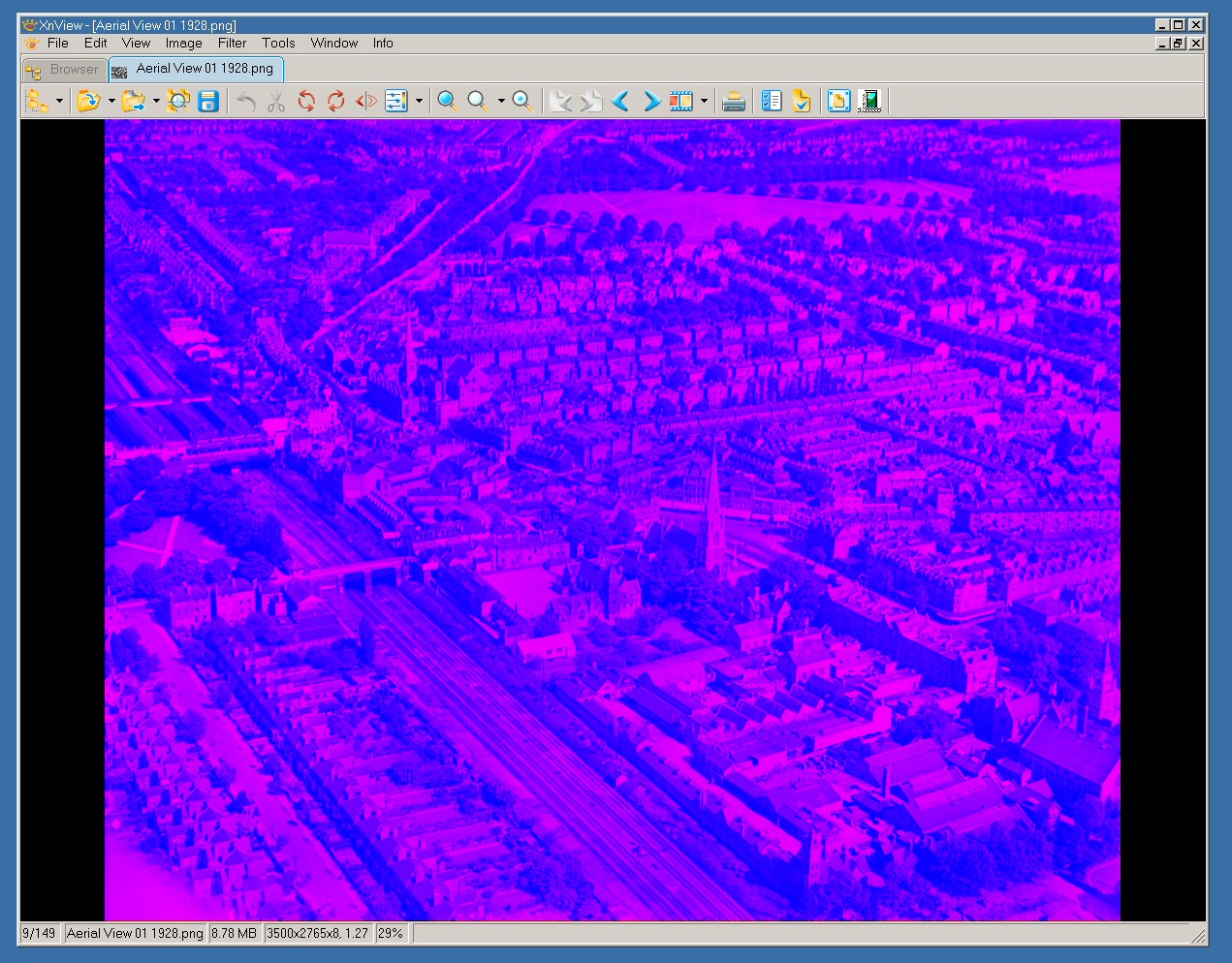

The first is the image I attached last time, the second is a large PNG image that shows the same problem, but is sometimes red and sometimes magenta, as here. The first one, the JPG, always seems to be red.
There are some others with the same problem, but I haven't been able to identify what they have in common!
They print fine, and their thumbnails are fine, it's just the normal view in XnView which is wrong.
Cheers, Dave.
