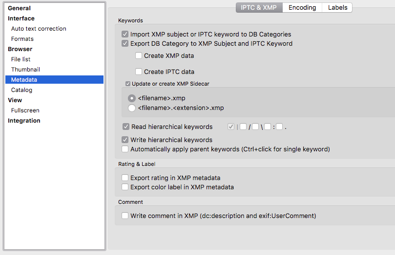

How can I apply categories to an exported image without changing the original image?
I have an original image with categories in the XMP and database (not in the picture itself!).
But when I export this image with batch processing, the new image does not contain any categories.
The information from the XMP or the database will not be transferred to the new image.
And yes, "Create XMP data" and "Create IPTC data" are off because that would otherwise change my original image.
Is there a way to change that?

mcbrx wrote: How can I apply categories to an exported image without changing the original image?
You need to disable 'Export DB Category'
Batch convert doesn't use this setting (only when setting categories). You would like to change XMP categories with batch convert?

xnview wrote:You need to disable 'Export DB Category'
Ok, but I had already tried that, it makes no difference.
xnview wrote:You would like to change XMP categories with batch convert?
No, at this point I do not want to change the categories.
I have already assigned the categories before, but only in the database.
The categories should simply be written from the database to a newly exported image (JPG).
The problem is that categories are only exported (with batch convert) if they already exist in the original image.
But an original image should never be changed.
(Maybe a new action in batch convert, "Add metadata from database" ..)
Thanks!
