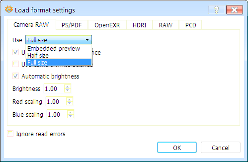

I'm going crazy. All I need to do is convert DNG to JPG. The ouput files are all reduced size 1024x768. I can't find the setting that is controlling the output size!

jazee wrote:All I need to do is convert DNG to JPG. The ouput files are all reduced size 1024x768. I can't find the setting that is controlling the output size!
I don't use a digital camera but I think this is probably the setting:
Settings tab > Load format settings...
