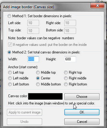

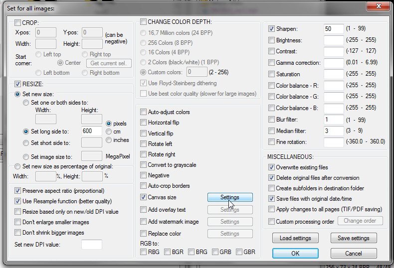

Re: Batch: Canvas resize to longest side
Many thx. I have found a way to do this with Irfanview, maybe this helps you to implement it. I go in Irfanview to "Batch Processing", choose the pictures to convert, advance options, check there "resize" as in the first screenshot and additionally "Canvas" with the settings from the second screenshot. As a result, i got all my pictures in 600x600px. I have not got it to work, to resize only picture they are to big, if i checked this, I got not the results, i expected. But that's ok for now.
