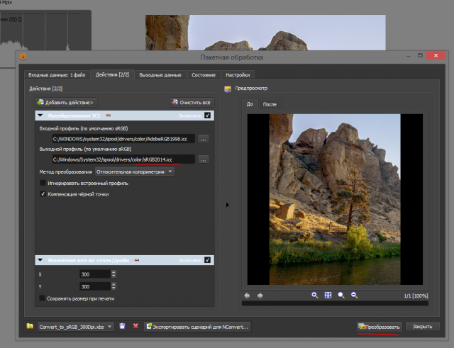

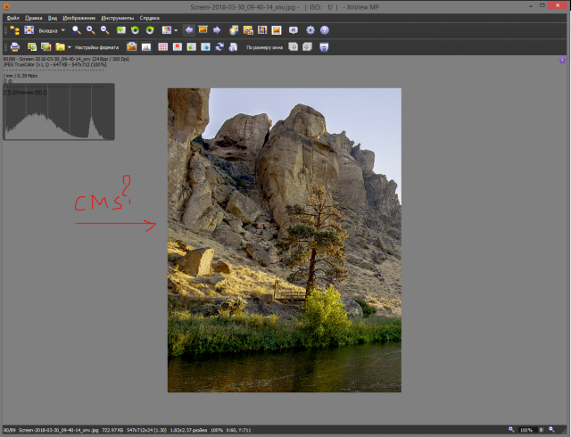

(1) The CMS does not work in the "view mode" window, "full screen mode". Probably can not associate correctly the built-in profile from that simply does not display it in the monitor profile, the visible "show" is like when the CMS is disabled.
(2) The CMS does not convert from one color model to another in the "batch processing" mode (*does not display the profile name in the file). It looks like the conversion itself is happening, but the name of the new profile is not written in the file tag.
(3) The built-in ICC Profile (*how to check?) Is not saved to a file (JPEG, TIFF, PNG).
The program lacks a menu - (1) assign a profile to a graphic file and (2) convert to a new profile from the current one.

AlexSikorsky wrote:OS Windows 8.1 / xnviewmp v.090

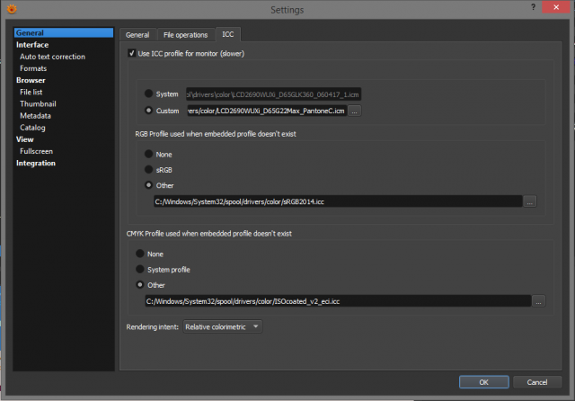

I checked it as follows: I assigned RGB for CMS settings - ProPhoto with gamma 1. If there is "no profile", the file will be assigned this profile and the picture will be light and oversaturated in color. Everything is working! And this means that there was a conflict, when in the file one sRGB was built in, and it was selected in CMS - somewhat different, but also sRGB.
If the profile is embedded in the block (Information / Properties / color profile), there is information "color profile", and if there is no such information in the file, this section will not be present in the file information block.
The error found (apparently irregular) has not yet been identified.

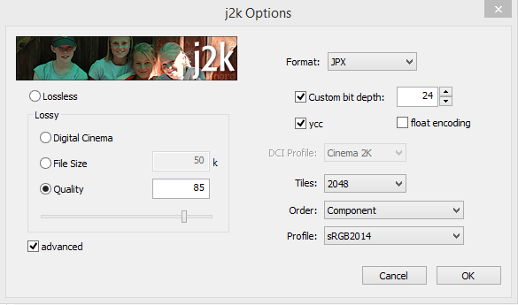

1. One and the same file is saved with the profile sRGB IEC61966-2.1 and with the profile sRGB 2014.
2. Further saved it in PNG, JPG, JPF, JPX, JP2, J2C
3. I looked through sequentially in the browser and in the view mode, switched for each file from one mode to another.
 8 times for yesterday and today the program fell (I noticed that this happens when switching from browser mode to viewing mode). I came to the conclusion that the problem is not in the work of CMS, but in the unstable work of this assembly.

XnView use CMS only for TIFF/JPEG & PNG format
could you send me the color profile used for your monitor?

xnview wrote:XnView use CMS only for TIFF/JPEG & PNG format
A display profile in the archive.

AlexSikorsky wrote: Fri Mar 30, 2018 8:50 am OS Windows 8.1 / xnviewmp v.090
I can't reproduce, when opening the file in edit mode, i have the same as in browser.
how do you obtain the second screenshot of your first post?
