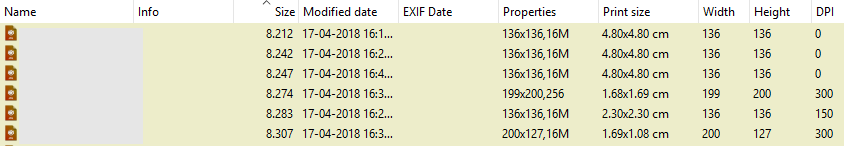

I have downloaded quite a lot of images and would like to delete images below a certain size (LxW),
so they would show up on the monitor, let's say at least as postcard size.
Q: How am I to proceed?
Considering that maybe the dimensions of the images can be small, but because of the high resolution, they still show up as fairly big on the monitor.
Probably I should start off deleting stuff with 200 pixels width?
The printsize does not always correspond with the size on monitor.
Width: 100 x Height:72
# of bit:8
Color mode:RGB
DP:300 x 300
Print siz:8.47x6.10 cm
shows a larger size on the monitor.
Bottom line, frankly, I would not know how to filter/delete small images (on the monitor).
It may sound as a newbie question, I know, but I would really appreciate any recommendations.
Thanks in advance!

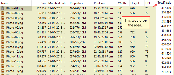

mrwul
Posts: 343
Joined: Tue May 25, 2010 7:01 pm
Re: How to filter images with specific dimensions?
Post by mrwul »
See attachment, this would be the idea. Hopefully in some next release...
Have submitted this as an idea in the 'Suggestions' section.
