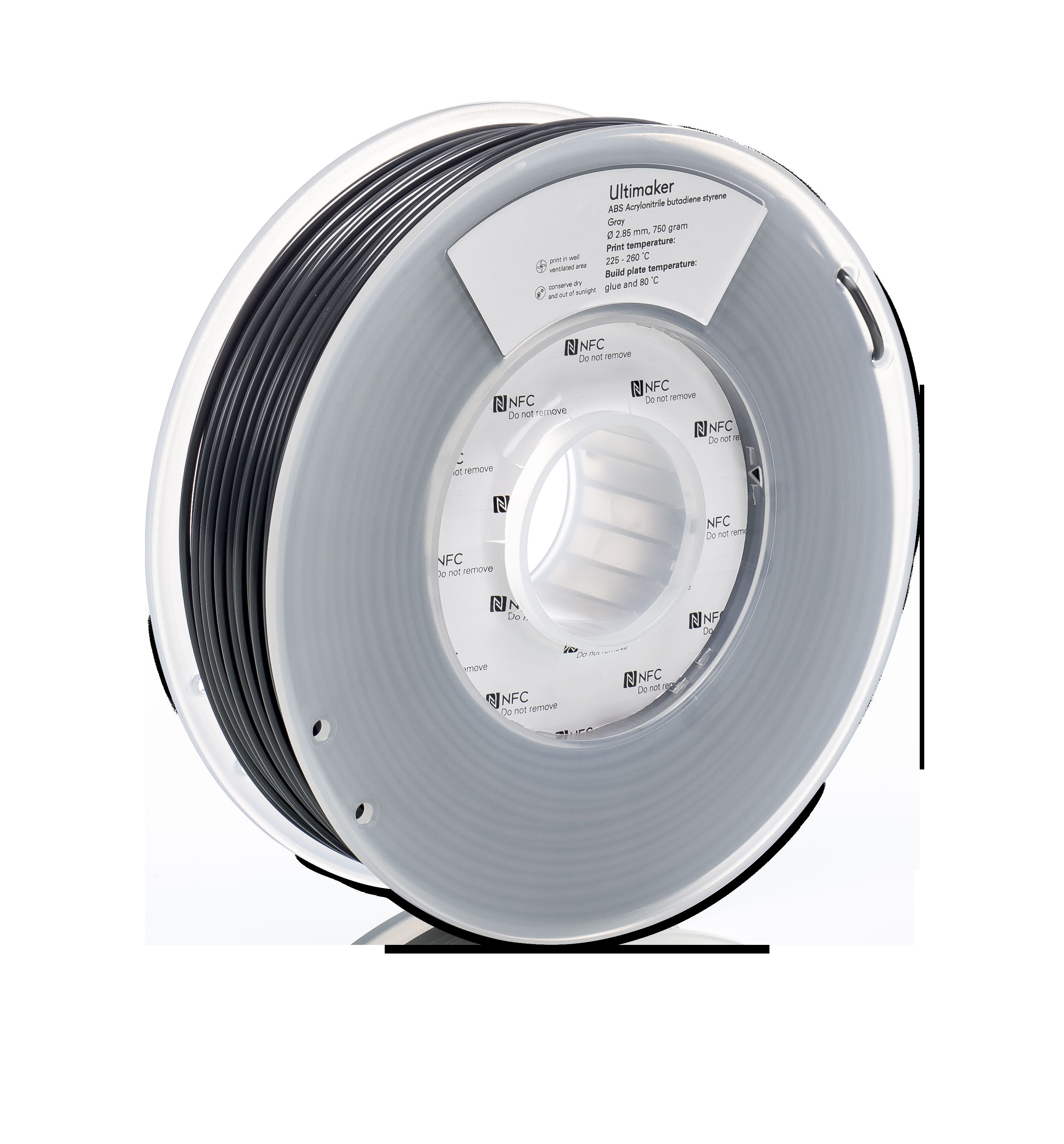

I am trying to convert images files from PNG --> JPG and am getting the frustrating black line some of the images (the images are all very similar). I've attached the export to show you what I am getting.
Does anyone have a solution to export PNG files without these lines?

XnTriq wrote: Sat Dec 19, 2015 10:45 pmAdding an extra action to change the color depth to truecolor before converting 32-bit PNGs to JPEG should do the trick.
Also related: Backgrounds when removing alpha channel
